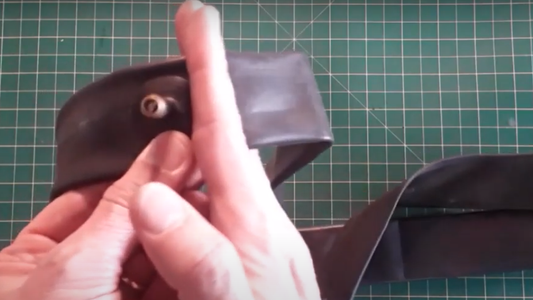

1-Using scissors or a knife, cut near cut near the valve to have the maximum use of the material
2-Cut one of the side folds to open the entire length of the bicycle tube.
3-Wash the inner tube with soap and water

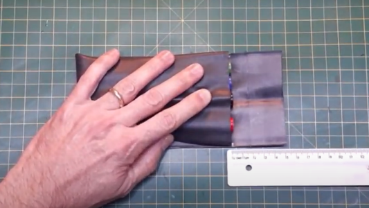

4- Evaluate the dimensions of the open air chamber to see what bag size you can make
Step 2: Sizing and Building the Bag

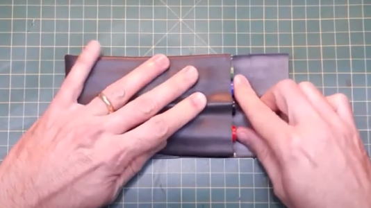

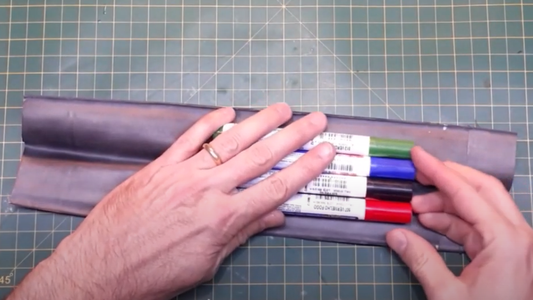

1-Take the objects you want to keep in the bag and check with the folded rubber if it is the proper size
2- In the width we consider the seam
3- In the length consider the closing flap

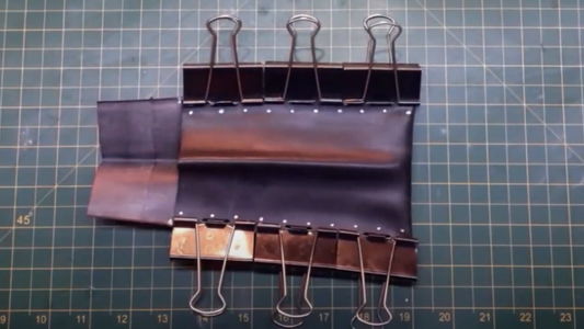

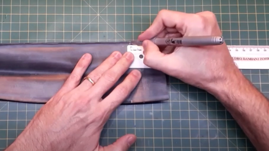

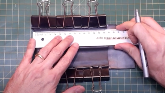

4-Use a light-colored permanent pen to mark where the side seam ends and where the closing flap begins

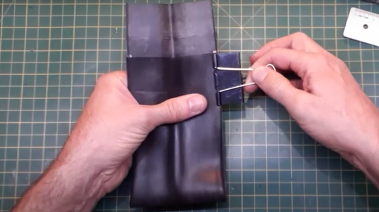

Use a binder clip, or pegs or paper clips to hold the rubber while marking, punching and sewing

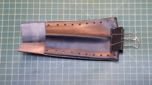

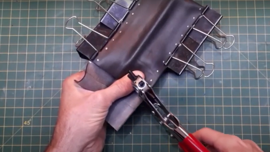

5-Secure binder clip so that it already maintains a distance from the edge of the rubber so that the holes are well located
6- Use a ruler to mark where the holes will go. If using 1/8-inch holes, drill the first hole from the bottom and the last hole from the top no more than 1/4 inch from the edge. Between the other holes you can adopt a spacing greater than 1/2 inch
7-Remove binder clip little by little while making the holes so as not to lose the position record
8-Keep a binding clip in the rubber crease at the bottom of the bag, this helps keep track of holes lined up for stitching.

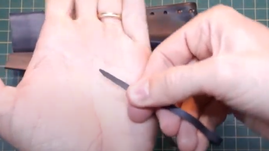

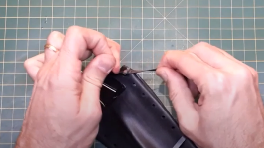

Cut 2 rubber strips with at least the same total length as the bag's rubber when opened. These strips must have the same width as the hole you adopted.
To sew , you can either use a large needle or simply sharpen the ends of the rubber bands to fit easily through the holes.

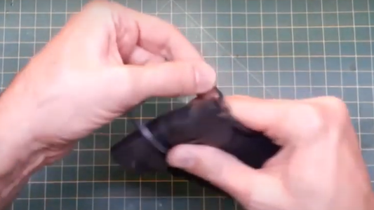

9- Start sewing from the bottom near the fold of the rubber
10-Make a double knot, either at the beginning or at the last hole

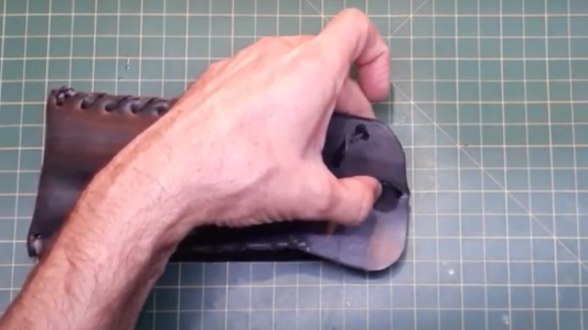

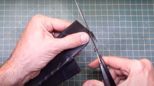

11- Join the sides of the flap to round the corners cutting evenly

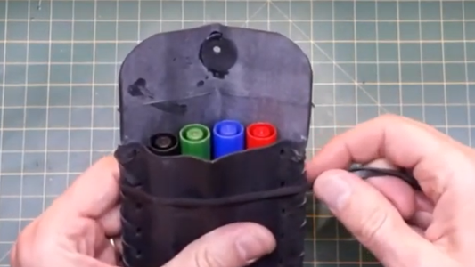

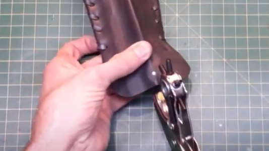

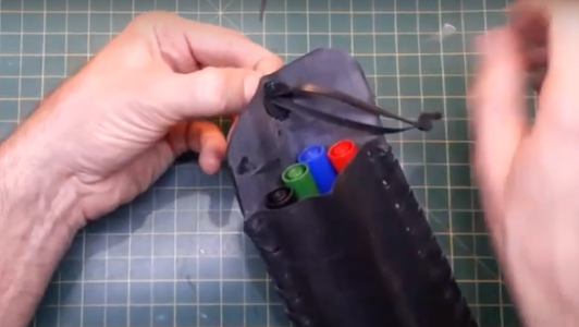

12-Mark the position of the hole where the bag's clasp will be located so that it is centralized
13-Glue a circular-shaped rubber reinforcement to the back of the flap at the point where the hole in the clasp will be
14-With the leather punch, drill the hole in the rubber for the clasp

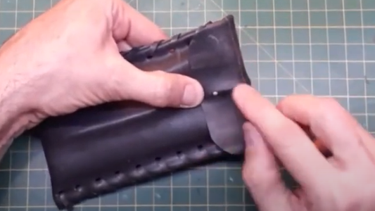

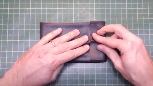

15-To make the strap of the clasp, take a rubber band and tie a knot in a loop that is the same measurement as the envelope of the bag.
16-Now take the finished rubber strap and thread it through the hole in the flap from the inside
17-to close the bag flap, simply bend it over the bag and holding with one finger in the center of the clasp, wrap the bag using the rubber strap
