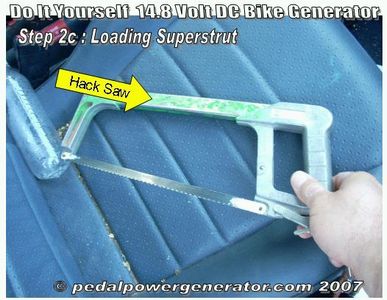

Step 9: Locate Saw
At this point you reach into your front seat of your ride and grab your trusty hack saw.

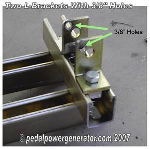

Step 18: Drill Mounting Holes in L-Brackets for 68 AMP Car Alternator
The hole in the L-bracket does not work for mounting the bike generator. You will have to make a small hole as shown in these 3 pictures.

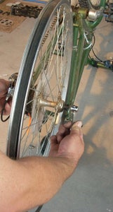

Step 21: Remove Rear Bike Wheel and Tire
Turn your bike upside down and remove the rear tire. The ascent bike stand comes with a spare quick release axle. It has hardened ends in the optimal shape to fit with the Ascent Bike stand. If you quick release axle has plastic ends, don't us it! Use the axle that comes with the bike stand.
Remove the tube and tire from your rear wheel so it looks like this. You can leave the rubber liner thing on if you want. It doesn't seem to make a difference.
NOTE: Make sure that your quick release handle is on the opposite side of your wheel that your gears are on. It must be that way to work in the Ascent Bike Stand!

Step 23: Put the Wheel Back on the Bike Frame.
Put the wheel back on the bike frame as shown in the picture.
Make sure the wheel is equi-distant from the frame. This is a very common mistake. Notice in the picture below how the gaps between each side of the wheel and frame are the same size. you need to do the same comparison check.

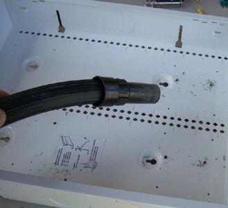

Step 29: Drill & Clean Holes
(1) Get a scrap piece of wood to put under the electrical box so you don't drill a hole into the nice table below like I did.
(2) Drill your holes in your box. Use a 1/4" bit.
(3)De Burr your holes for safety reasons - to avoid cuts
(4) Use a vacuum to clean up the shavigs - they are sharp!
