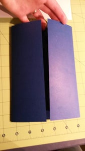

1. Mark the middle of your blue paper. (Measurement is on step 2)
2. Fold the left and right sides to the middle making sure that the bottom and top edges stay flush. Use the bone folder to crease the edges.
