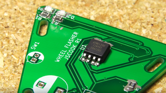

Step 4: Melty Melty!
Apply parts, melt solder paste, solder on surface mount components.
Step 5: Program
Program the ATtiny85 using a programmer and chip clip. More info on programming this chip is found here. Code is based on this previous project, and simply cycles from one LED to another.
Note that while ICSP headers seem to be available, I made an error or two here–best to use the clip.

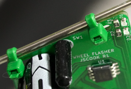

Step 6: Zip Up!
The PCB is designed to attach to a bike's spokes via zip ties. Loop the ties as appropriate and tighten.
Step 7: Ride!
With this in place, when your wheels go above a certain speed, power is applied the lights will start flashing. An earlier revision started flashing by hooking the sensor up to the reset. This worked at lower speeds, but at high speeds the reset is simply triggered all the time.
