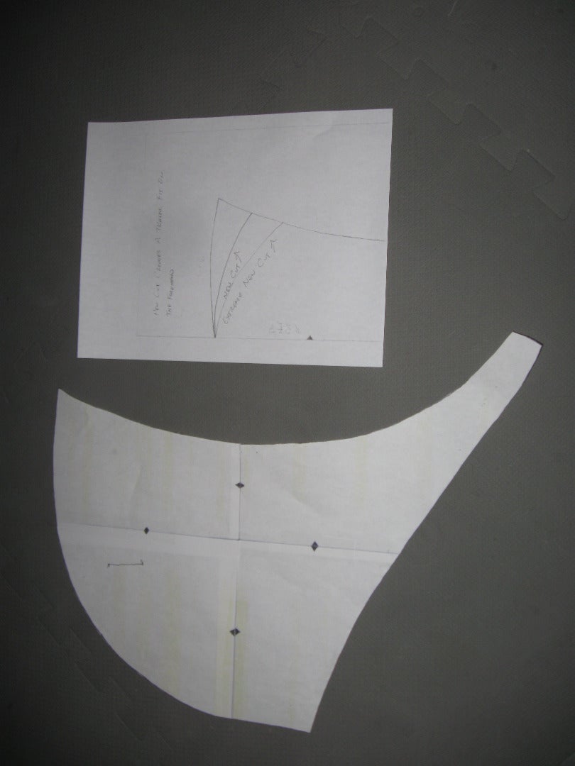

I have a disproportional melon so that gives me a... New Cut! Extreme new cut is for smaller melon .
The first of 3 major changes are the more radical cut on the front of the 4 cowl pieces shown the the downloadable pattern.
Firefox is the Cowl PDF while the other two are for the Bunny!
OK so you got this far. Print out both the patterns, decide if you need the new cut or traditional, then cut and assemble the pattern as shown HERE

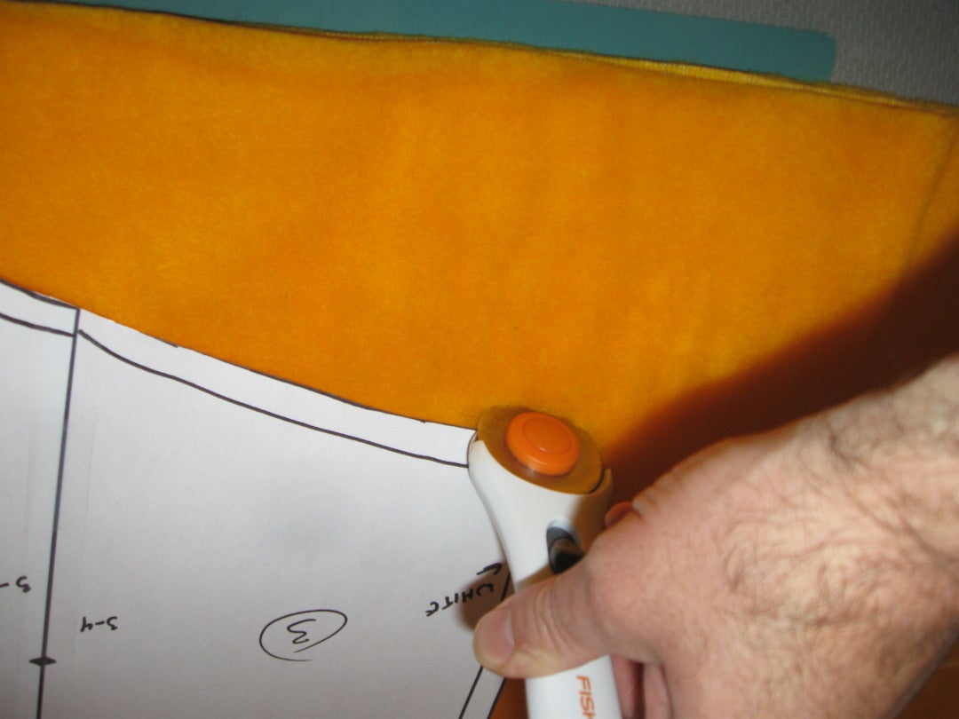

You will need to prep and cut your material of choice. This one is brown fleece. A guy wearing bunny ears is weird enough but if they were pink, that just screams white van!!!
Careful inspection will show that I the more drastic profile on the front cowl tucks the front down and creates a more form fitting tribute to Louise!
The orange is for Firefox.
I chose brown fleece for my remake for obvious reasons. And the Tech, well these ears will give you bionic hearing

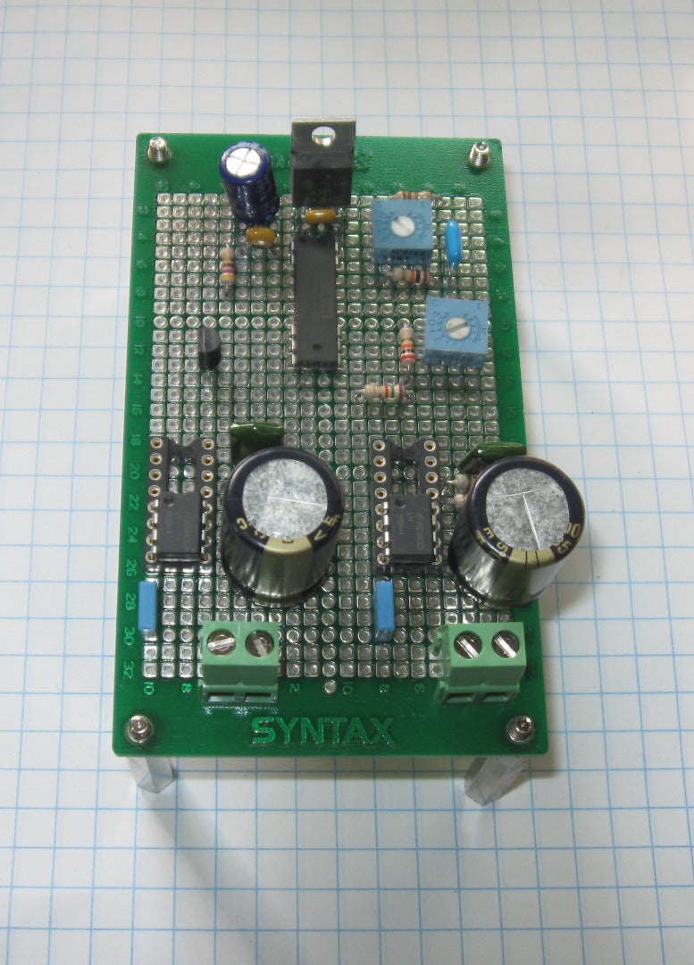

From here you can inject the microphone input to the amplifier circuit There are a couple of standard circuits that you can use. The final board circuit shown here tends to be a little big and messy.
The first board in the pictures after the circuit diagram has a preamplifier circuit in it, this did not work out so well ant is seemed to pick up and amplify a local AM radio station.
It was redone without the pre-amp with way better results.

I decided to make the circuit a little more compact.
One noticeable change is that I have included 2 individual audio POTs to work a volume control, this tied the amplification of both ears together yet still allows for individual circuits. It is really spooky to have the microphones be able to pick up audio yet still allow for differentiation location of the source of the sound.
Again the circuits are contained in the box device. I just connected orange to positive and green to ground as shown. be careful to get left and right to the proper orientation.
The more compact circuit is housed in a Hammond 1500 series case that has a 9V battery compartment. I can easily put this one in my pocket with no chafing.
In this case the white/pink lead comes from the microphones and must go through the circuit that is inside of the black box as previously discussed. The red lead goes directly to the headphone circuit. The microphone volume is controlled by the 2 audio pots that are on either side of the mic input.
The wiring will have to be cleaned up as it looks somewhat messy in it's current configuration.
