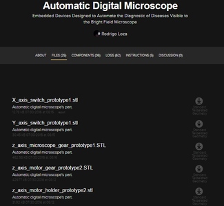

To get all files mentioned further on you should go to this page:
https://hackaday.io/project/10188/files

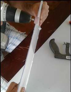

First, you will need a 1.80mx0.90m sheet of acrylic. You can find one for 13$ in a local store. To cut the acrylic sheet a CNC would be the best, nevertheless, we do not have one. Thus, we used a saw. The measures can be taken from the CAD file namedbox_to_store_and_collect_biological_samples.stl.
Step 3: Building the Structure! - Pt 2
After cutting the acrylic, you have to use a milling machine to fine tune the sides of the cut parts. Then, the material is ready for being glued. You can use chloroform to seal the parts, this chemical melts the acrylic and creates a strong chemical bond between the two parts. Remember that they need to be fine tuned otherwise they might not glue because they will not be close one to another and the chloroform does not fill the missing parts. Of course, it is hard to fine tune the sides, thus, you may have some not sealed parts. To seal this missing parts we recommend using hot silicone. Actually, we found that the only useful glue is hot silicone, it will fill and seal all your empty parts. Do not use any cold silicone or acetate based glue, they are completely useless.

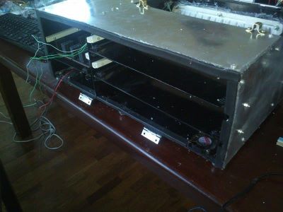

Step 6: Building the Structure! - Pt 4
Next, we are going to add the rails and trays to put the slides and the biological sample containers. For this task, you can use a drill and screws. Then, let's add the two doors. We are going to use hinges to secure the doors.
Step 7: Building the Structure! - Pt 4

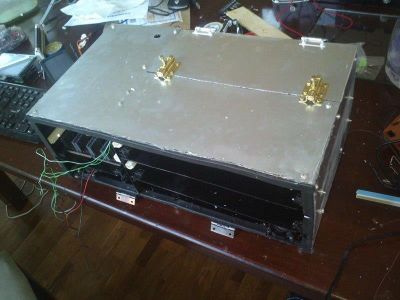

The box is almost done. In the design log, we decided to use tarpaper to make the box similar to a thermos. Nevertheless, tarpaper is expensive (15$ half square meter), therefore, we decided to use reflective painting. The inside will be painted in black, meanwhile the outside will be painted in gray.
We took out the door first to paint everything.
After painting the box, we will proceed to make hermetic the doors of the box. For this task we will use the rubber that is used at car's doors. Use hot silicone or a glue called "LA GOTITA". Glue the rubber to the sides of the doors.
Step 8: Building the Structure! - Pt 5 (Final)
Next, we are going to make the locks for the doors. For the upper door we have used common locks found in any supermarket. Use a drill and screws to secure them. Then secure the door by screwing it to the hinges already placed.

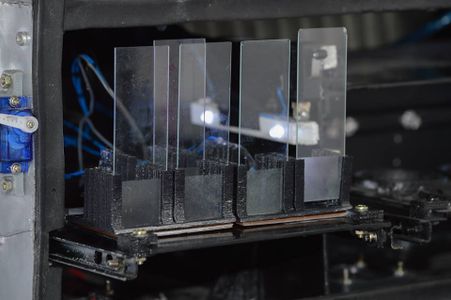

Step 10: Building the Electronics! - Pt 2
Next, we are going to add the slide holders. The schematics and PCB can be found in the file section and explained in the design log.
Step 11: Building the Electronics! - Pt 3
Then, we are going to glue the PCB and the 3D printed design (the 3D printed design can be found in the file section).
Step 12: Building the Electronics! - Pt 4
The next step is to glue this slide holder to the tray (This tray was also built from the acrylic sheet and then painted black). Use hot silicone. You can also see the white leds that we have added. This will be useful in dark places.

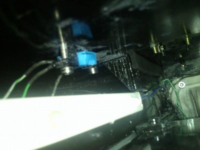

Add White LEDs to the walls so they can be turn on when the door opens. This is to improove visibility when checking the samples. Add UV LEDs to the back walls so they have a greater reach.
For this task you can use the rail plastic. Place groups of 3 UV LEDs in each floor of the container's trays, the slide holders' tray and the compartment to store protective equipment. Then place groups of 3 LEDs in each wall of both trays.

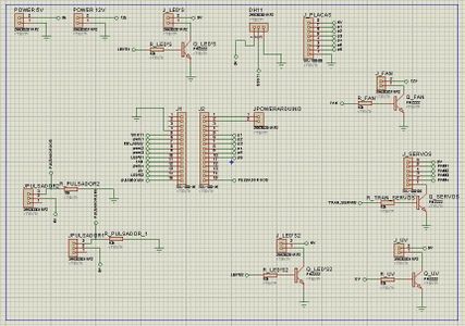

Step 18: Wiring It All! - Beta Pt1
Once all the sensors, leds, fans, servomotors, locks, etc have been added, we can proceed to make the PCB. Use the following schematic to guide yourself with the circuit. This schematic misses the ESP8266 which is conected like this:
esp Arduino
rx -> tx
tx -> rx
Vcc -> 3.3v
Gnd -> Gnd
Gpio0 -> D6
This schematic, although will give you a good idea, its implementing a code developed to run with the arduino nano. On our current code, pins and connections are made to work with an arduino Mega as shown in the pictures.

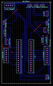

Step 19: Wiring It All! - Beta Pt2
Then, we can proceed to make the PCB use the file named Box_to_store_and_collect_biological_samples_PCB.prt to print the PCB or use it in another way to build your PCB.
This PCB is to use with the arduino Nano with the pinout shown in the schematic on the last step.

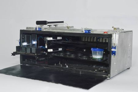

Step 27: DEMO!!!!
Here is a fully functionating demo.
