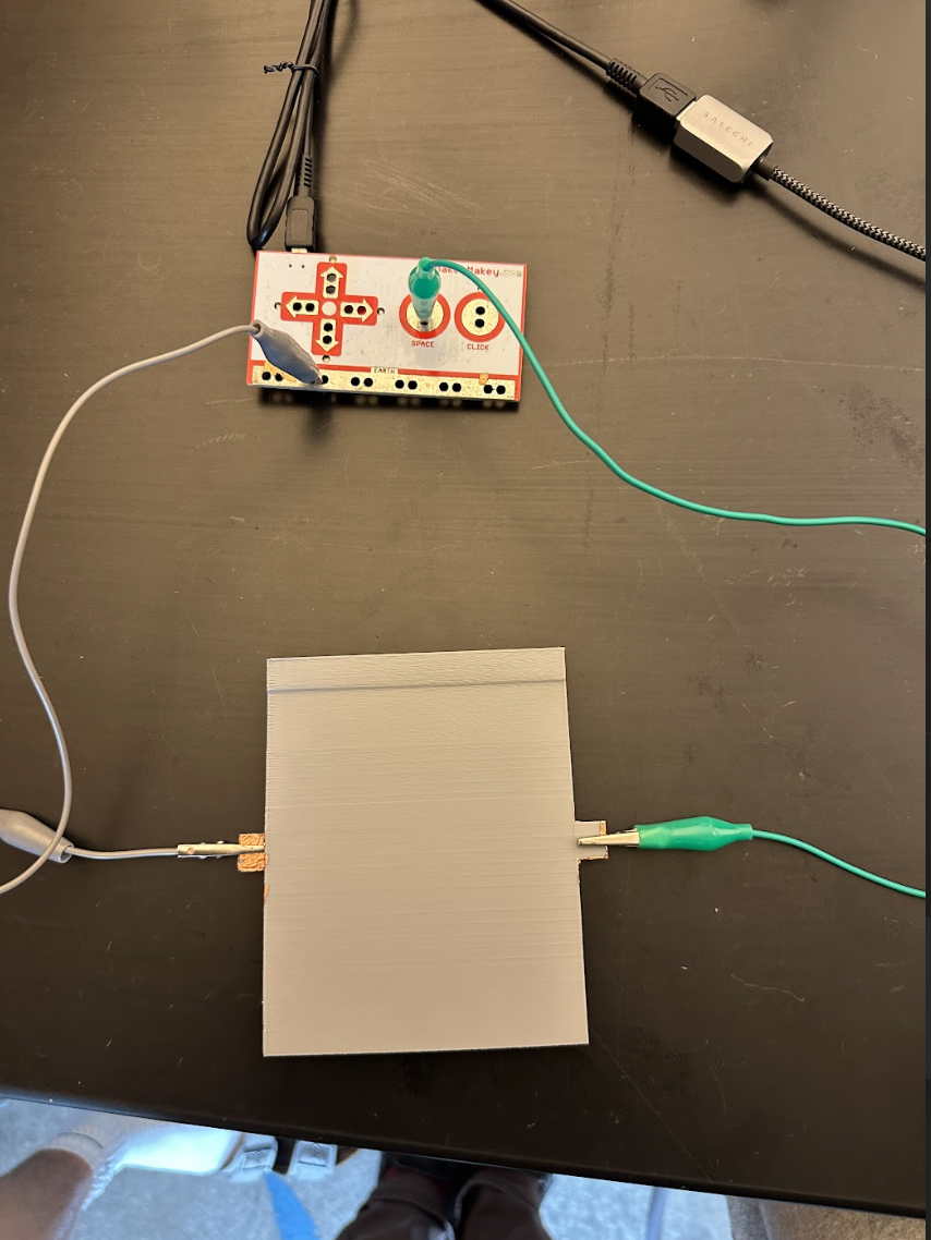

Step 2: Apply Copper Tape
To apply the copper tape on the inside of the printout, what I found was easiest was to roll the tape just a little bit back on itself and stick that to the top or bottom of the inside, as shown. Once I had the start taped, I pushed and pulled the solid backing of the tape in order for it to go somewhat straight. If it doesn't go straight the first time, just apply another layer. The finished product should be a strip, or however many it took, of tape going from tab to tab on the inside. Make sure that the tabs also have tape on them.
Step 3: Connect Wires
Attach the wires to the tabs in the center. For the best button performance, make sure the alligator clips are only partially attached. Clip them just onto the side tabs—these tabs have tape on them, which helps improve how the button works.

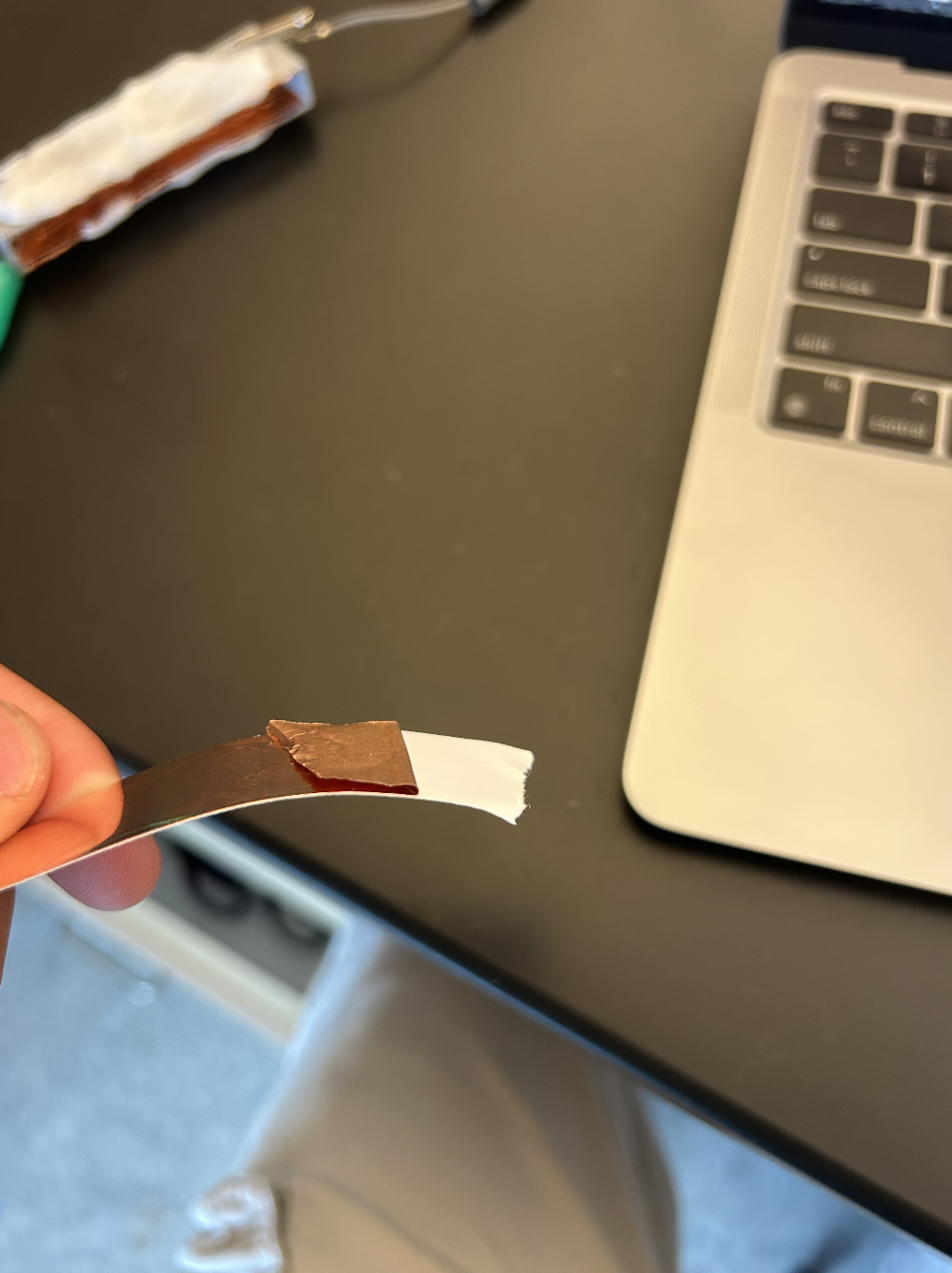

Step 5: Apply Copper Tape
Similar to the button-press switch, you can use copper tape in the same way by folding it slightly back on itself to make it easier to apply. For this version, the tape should fully cover the inner surface, as shown.
Step 6: Apply Polymorph
Follow the instructions for using the polymorph, and apply it to both the top and bottom surfaces. This helps create a more comfortable and secure grip in the mouth.
