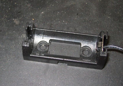

Well I wanted to take out the old batteries and install some Lithium-Ion batteries so they would be easy to replace in the future. I decided on a Li-Ion 3.6V 650mAh Rechargeable RCR123A battery. 2 of them in fact. Hooking them up in parallel will equal the original voltage. 3.6 is the original voltage. These batteries will not have the memory problem of the old batteries. You will need a new charger for them because the old one will over charge and you might have a fire. You'll also need 2 battery holders that are the right size for 123A batteries.

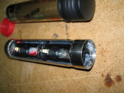

Now that you have it off it is time to use the dremel to cut out the end so we can remove the batteries. Don't forget to use your goggles.
Try and cut as close to the edge as possible. There is a rubber washer on the inside at the end and will probably start to smoke once it heats up. You'll see it once you start cutting in deeper. Remove the rubber washer. Once that is done the batteries should fall out. Just tap it on the table and it should come out. The battery that comes out last will have a metal cup spot welded to the positive terminal. Use the screwdriver to pop it off. Don't bend it. We need it. If the screwdriver isn't working, use a putty knife or pocket knife.
Now you can start cutting out a large slot like you see in the picture. Make it wide enough so you can fit the battery holders. Make sure the battery holders are set in deep enough with a battery installed. You don't want the batteries to be sticking out. Be sure and sand all metal edges so you don't end up cutting yourself.

Ok, now we get to solder. We are connecting the battery holders in parallel. In other words the negative to negative, positive to positive.
Here is the line up.
The small metal cup is the positive. Solder both positive wires (red) to it. Solder the negative wires (black) to the bottom of the case. The small cup fits in the top of the battery case. I used Duco cement to keep it from moving. You could use super glue as well.
I used a glue gun to keep the battery holders positioned. Before you hot glue anything test it first. Once the hot glue sets, it will be very hard to get to the wires if something is amiss. If it isn't working check your soldering connections. Is the battery charged?

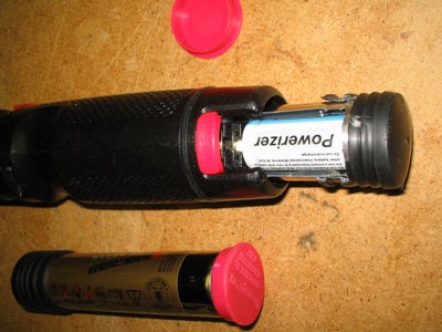

1 more update: 11/28/21
I have not used it much in the last 5 years. The old batteries finally died and the driver is wearing out. I took it apart all the way down to the gears and cleaned it up. Relubed it and decided to upgrade it finally to a 18650 battery. It works fantastic now. Emery cloth was used to take up some slack to prevent the battery from jiggling around. 2 springs hold it in place and can utilize any length of battery. 18650 are known to have different dimensions. This is probably the last update for this Instructable. It has been by far my most viewed Instructable. Thank you everyone for taking a look and I hope it has inspired you to take a look at some of your old equipment and maybe do a mod to keep it out of the landfill.
