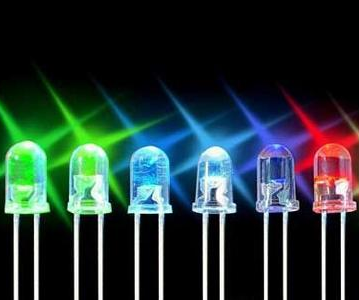

Hardware:
  • STM32 Black Pill board
  • Jumper wires
  • LED
  • USB-C
  • Breadboard (optional)
