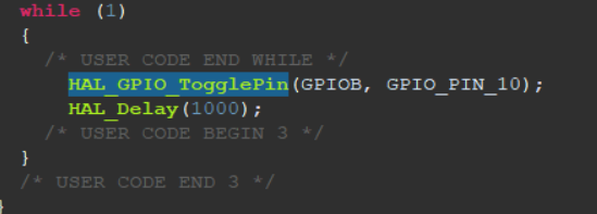

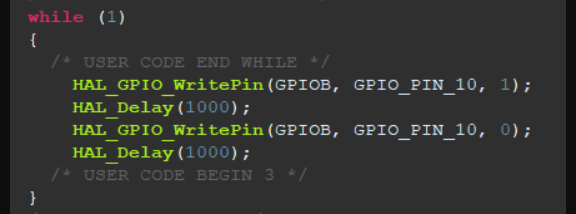

  • Go to line 95, in "while(1)" write the code to send a HIGH [digital 1] output, then add a delay and send a LOW [digital 0] output to the LED.
  • Your code should look something like in the attachment.
  • You can also use toggle function.

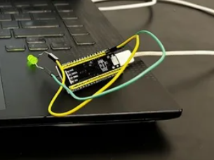

Step 5: Interfacing of External LED
  • As I chose PB10 for GPIO, I'll connect the +ve terminal of the LED to it.
  • And connect -ve terminal of the LED to GND. You can check the pinout of ground from attachment shown above.

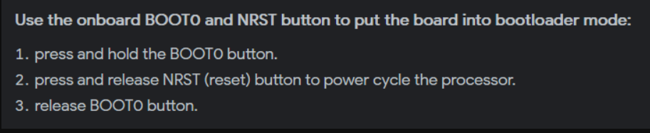

  • Enter boot-loader mode by the steps in the attachment. Refresh until it shows up and press "Connect."
Your STM32 board should show up in the device manager under Universal Serial Bus devices if done correctly.

Step 7: OUTPUT
