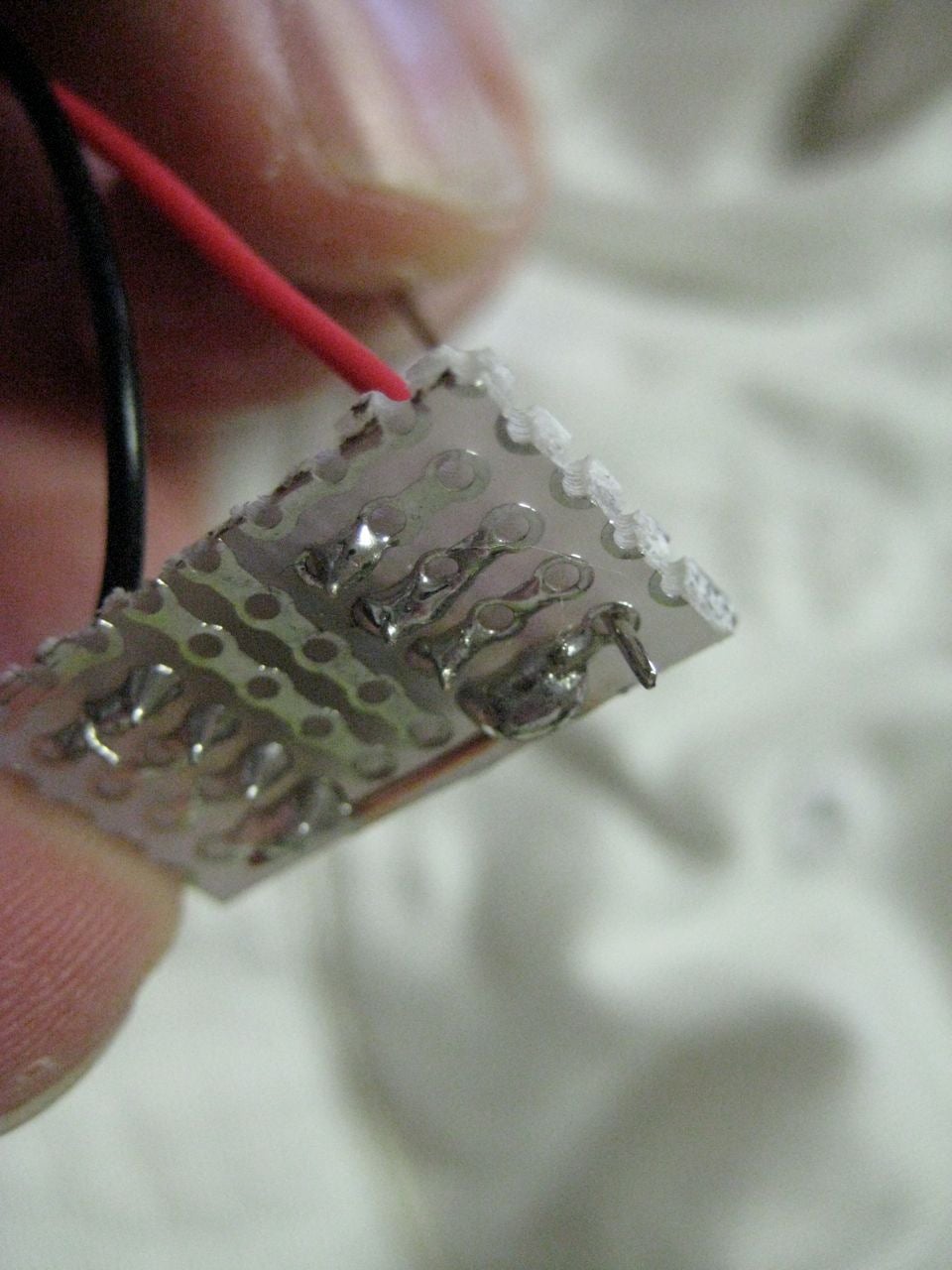

Step 2: Prototype #1
Prototyping is important!
Most of the wiring is just moving things around so that it all fits on the one board.
Coin cells are awesome for doing stuff like this midi-breadboard.

So the prototype was compressed down to a little piece of perf board and a battery pack.

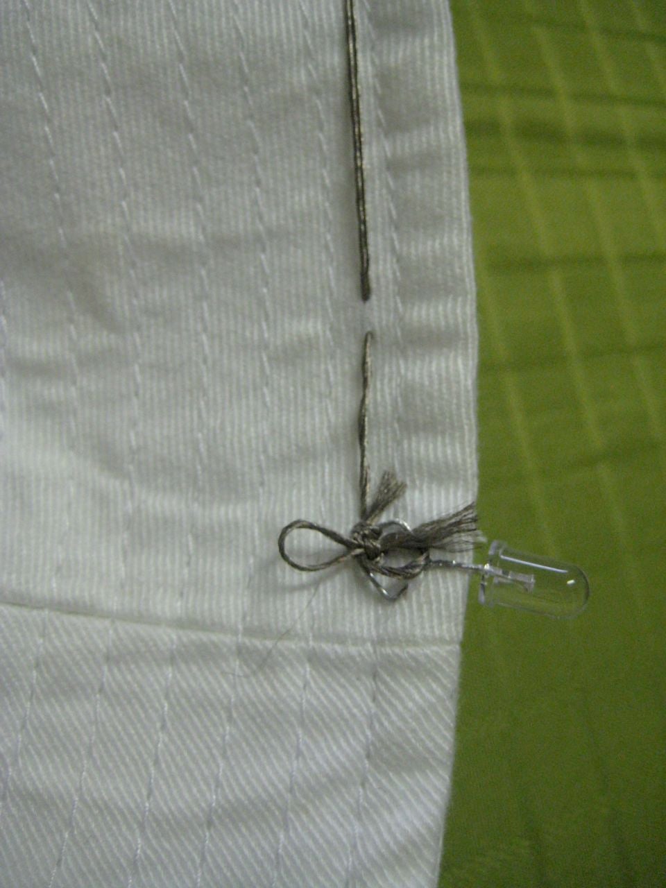

Step 7: Grounding!
Sewing on the underside of the hat, do long skipping stitches and make sure to wrap the thread 3 times around the metal part of the LED as you stitch past it.
Finish up by bringing the ground wire up the inside of the hat and then through to the ground pin on the controller.
Step 8: One LED at a Time...
Once you've put a few wraps around the LED, slip the needle up the middle of the two layers of the brim of the hat and have it come out at one of the stitched perimeter rings -- we're going to put both LEDs onto a ring of thread - starting from the inside edge of the brim, 1-4
When you get done, test to make sure it works by putting batteries in!
