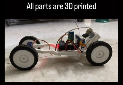

Introduction: Bluetooth Controlled 3d Printed RC Car With Differential Gear Mechansim
I saw one very old black-and-white video surfacing on Facebook explaining the need and working of differential gears in automobiles. So I decided to make one complete assembly of differential gears.

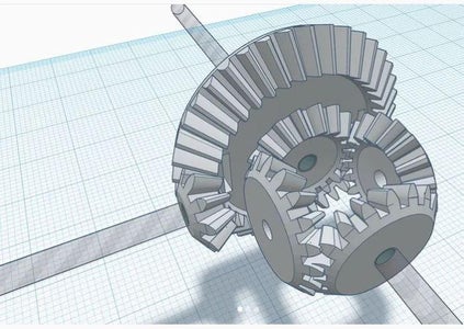

Step 1: 3d All Parts Attched Above As Shown Image
The attached image shows the assembly of gears and the names of different gears in the differential gear assembly. You can open completed.stl to view the arrangement of different parts after printing. I have used a 2 mm cycle spoked wherever I needed the shaft. you can also purchase the same from a repair shop or u can use a carbon fiber rod of 2 mm diameter. Be careful while applying superglue on gears and rod coupling.
