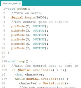

Step 1: Uploading the Code
To receive and process the commands, you need to upload the code given. Here you can change the character that controls the outputs, and you can change the pins used for outputs.
Load the program into the Arduino IDE software and upload it to your GlowDuino board.
If you wish to re-upload a modified program, make sure to disconnect the Bluetooth module, so the module does not interfere with the serial lines.

Step 4: Using the Outputs
Once connected, you can use the premade buttons at the bottom of the screen to switch the LEDs. These buttons contain a number, which corresponds to the given output pins of the microcontroller. Pressing these buttons will send over their content over Bluetooth, which can be read with the serial function of the GlowDuino. Analyzing each character with a simple row of "If" statements, the microcontroller can determine which button you pressed. One by one, the buttons will toggle the outputs, according to the trigger numbers from 1 to 6, thus controlling anything connected to them.

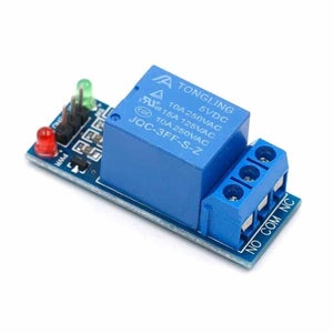

Step 5: Expansion Option
In case you wish to control something other than LEDs, you can connect a relay module to the output of the GlowDuino. The indicator LEDs will still signal when the output is ON or OFF, but you will have a way to control higher-power appliances and lights.
If you are using a relay module, the wiring is simple and easy. These modules have their pin labeled, which you will have to match with the corresponding pins on the microcontroller. +5V and GND are needed to power the modules, and each of their control pins (usually labeled with "in1" or similar) needs to be connected to one of the controlled output pins of the microcontroller.
