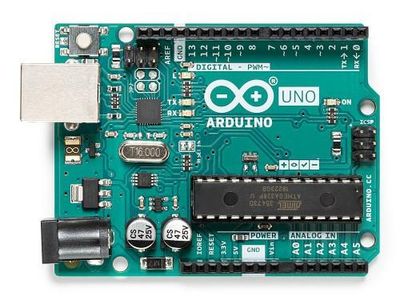

1) Arduino UNO

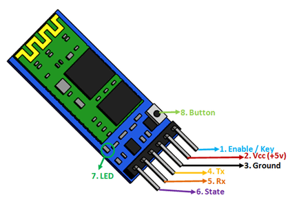

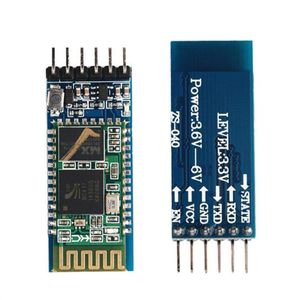

2)HC-05 BLUETOOTH MODULE

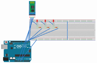

Step 2: Connections:
The schematic is very simple. All you have to do is that:
1)Connect Rx of HC-05 to TX of Arduino UNO.
2)Connect TX of HC-05 to RX of Arduino UNO.
3) Connect 3 led's +ve terminal to 13,12,11(Digital pins) respectively.
4) Connect all 3 led's -ve to GND of Rduino.

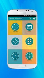

The application I use is Arduino Bluetooth control which you can download by play store.
So, after connecting to the HC05, You have to do the following steps:
1)Go to the settings of the app.
2)Go to voice control.
Set the voice sentence & sending an integer according to the code.
For Example=
In the sketch, I have written that If the value is 1 then turn on leds.
In-app you can write any vocal command like"TURN ON LED" & sending command to 1.
