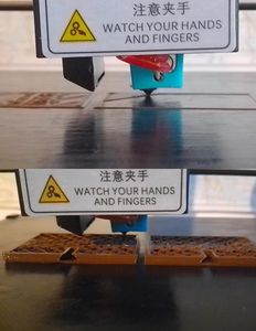

After a few prototypes, I created a beautiful design in book form and drew it with Tinkercad. In order to use as few supports as possible for printing, I split the handles and clamp bodies, we will glue them together later.
Print out two handles and two clamp bodies. All parts can be finished with sandpaper for a beautiful surface.

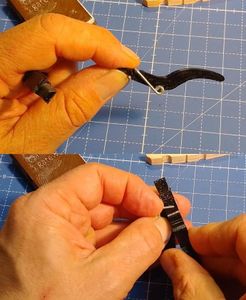

Step 3: Placing the Spring
Remove the spring from the prepared wooden clothes peg and place it in the new peg as shown in the picture.
