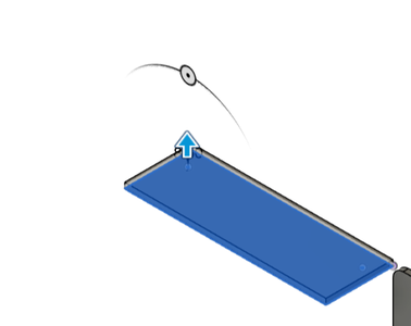

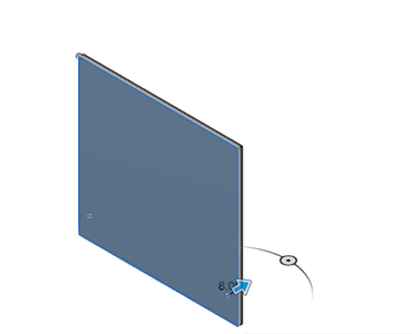

1- Main body:
  1. I started by saving the file on fusion, named it, created new component ( main body) and created a new sketch.
  2. made a rectangle with the following dimensions ( 320*290 mm)
  3. Then I clicked on finish sketch, extrude to give the main body the thickness of PLY wood which is 8 mm.

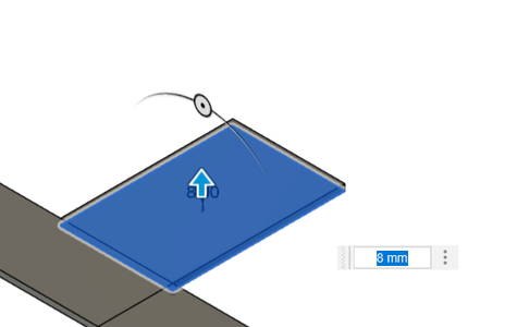

2- Shelfs:
  1. Created new component, create sketch.
  2. Drew a rectangle with the following dimensions ( 320* 100 mm)
  3. Finish sketch and extrude ( 8mm thickness)
  4. do the same steps one more time to create the other shelf.

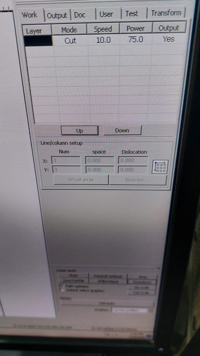

I used the laser cutter to cut the main parts of the project to get a clean cut and as i was worried to use the table saw at first but then used the table saw to cut few parts ( the back panels and the back )
After uploading the file on laser works, I arranged the parts along side each other to take the most out the wood.
To cut wood using carbon dioxide laser you need to adjust the speed and the power of the laser beam to cut the wood according to the thickness, as the wood sheet was 8mm thick, the power needed to be stronger, and the speed is slower than if you will cut the 3mm wood.
Speed was 10, and power was 75.
For the space in the 2 shelves for the acrylic sheet I designed a rectangle with the following dimensions ( 29.5*3)
then engraved this on the shelves using the laser cutter withe the same speed and power.

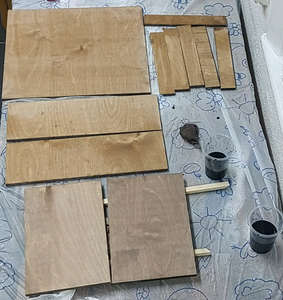

Step 6: Staining
To stain the wood you need sanded pieces.
I used water based wood stain.
Used water to dissolve the powder and the you can use any material to spread the stain i used cotton wrapped with mesh.
Applied more than one coat to reach the desired shade and between each coat and the other I left the wood to air dry about 30 minutes.
One small problem about the ply wood that after staining the wood had this strange texture, so i sanded again with sand paper (330) to remove any undesirable texture.

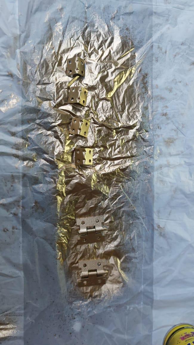

Step 7: Spraying the Hinges
The original color of the hinges didn't suit the shade of the stained wood, so I sprayed the hinges with gold spray paint.

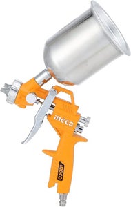

To use it put equal parts of sealer and thinner, stir well, the you have 2 options, to use a paint brush to put the sealer or to spray the sealer with the pressure spraying machine.
I used the second option to distribute the sealer equally.

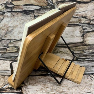

Step 11: The Wire
To shape the wire of the project I used heat gun to soften the wire and shape it easily, then inserted it in the back panels to support the book holder.
