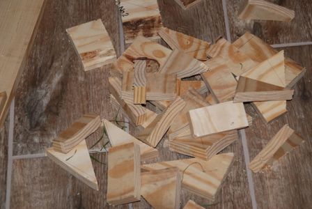

- Next go through your 1” thick boards and decide what you can use.
- Using a pencil and ruler mark off lines so that you get a bunch of triangles, squares and whatever shapes that you like.
- Place board on a sturdy surface (I used two chairs, be careful as you get to the end of your board while cutting)
- Following the lines you drew, cut out your shapes. I used a jigsaw. Go really slowly so that your lines will be straight and it’ll be easier to fit your pieces together later.

- Once you have all your pieces start playing with them on the board you selected to be the top of the shelf earlier. Play w/ different designs until you see what you like.
- I started from the top corner and started to work my way down but…
- In retrospect I would have started in the middle and worked my way out which is what I started doing after I realized I didn’t have enough wood pieces to cover the entire surface. If you use the resin then just decide where you want it to show the most. Mine was kind of trial and error but yours doesn’t have to be.
