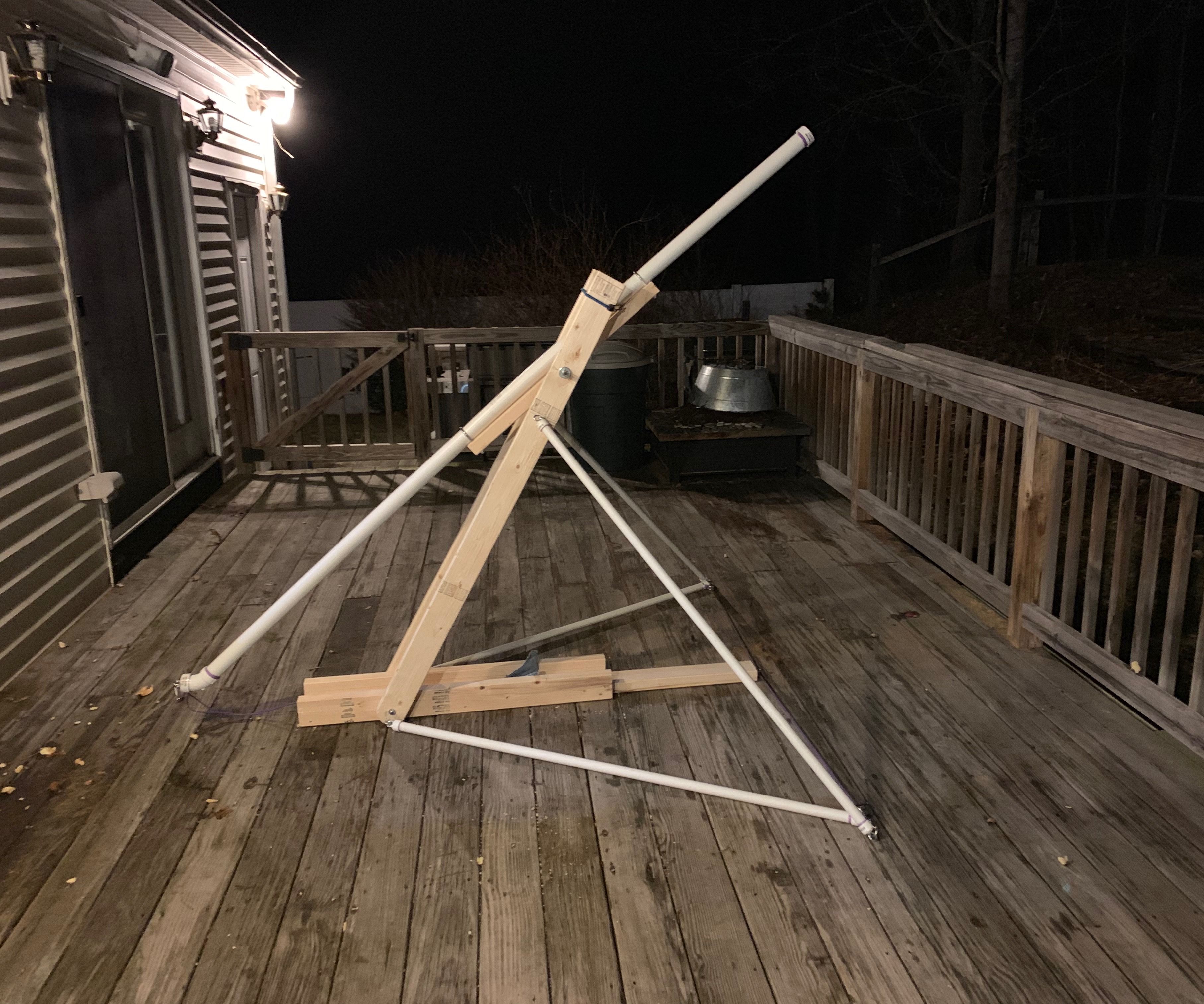

Like sewing i won't go into to much detail on plumbing, other than using the hand saw and mitre box cut the PVC pipe to 8 @ 9" and 8 @ 30". Using the PVC glue, I glued the elbows to the 9" pieces and the caps to the 30" pieces. Optional if you want to glue the 9" pieces to the 30" pieces. I did not as there is a storage issue once it is all together.
Center the body of the template on the plywood as shown in the picture. On the four corners since the width of the plywood is 6" less than the width of the template I moved the lines in 2 more inches. Cut these four lines and mark the front of the plywood. On both ends of the plywood mount the 2"x4"'s. As show in the picture align the edge of the 2"x4" at the corner on both sides for front and back. Using 3 - 2 1/2" screws per 2"x4" pre drill then screw them in each 2"x4"
Now we need to draw the lines to mount the lower part of the skeletal legs.
On the front to the right from the center line of the 2"x4" measure to the left 6" and draw a 10" square line. Repeat on the other side. From the same center line draw a 3" line to the right and draw a 10" square line, also repeat on the other side.
On the back end of the plywood from the center line measure towards the front 3" and draw a 10" square line on both sides. On the two back corners measure 6" toward the 2"x4" and draw a 10" square line for both sides. We should now have 8 - 10" lines.
Now we mount the 8 - 9" pieces of PVC. For each one first just start two 1 1/4" screws with two copper hangers. Then turn them over and align the middle of the elbow with the edge of the plywood and put the other two 1 1/4" screws. Repeat for all 8. Now you can add the 8 - 30" pieces.
