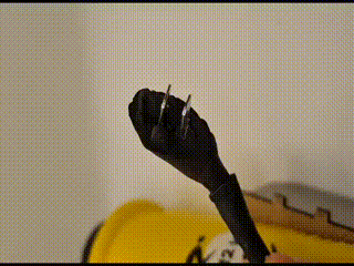

Step 6: Mould the Bike Connection
!Make sure the wires fit trough the hole before moulding this!
Push the male spade connectors into the correct terminals of your battery (should be marked with + and -. Once they are correctly positioned, mould the paste around it until you are satisfied with the result.
Follow the instructions on the packaging for drying times etc.
