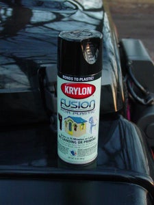

After masking, I lightly sanded the uncovered plastic with fine grit sandpaper. Since I use Krylon Fusion as a primer, this is not really necessary, but I think it helps the paint stick better. ***EDIT***Clean the whole thing with rubbing alcohol to get rid of any oils and dust after sanding
I applied a coat of black satin Krylon Fusion as a base. Once dry, I Painted over the black with a thin coat of silver metallic, and then "dusted" with a very thin coat of a gold/coppery color I had. This gave it a thematic / chromatic similarity to my other jars, but still maintained a unique silvery color.
