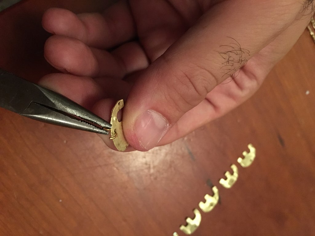

Step 6: Attach Them to the Necklace
After all elephant pendants were ready, I drilled a small hole for the chain loop.
To do so, I again pounded gently using the nail to create an engraved socket for the drill (see picture), this will ensure a clean hole without damaging the pendant. Then I drilled a hole for each of the pendants.
Since the pendants were handmade and not totally equal to one another and since I had no way to know where exactly to place the hole, I noticed that they needed to be vertically balanced. To fix this, I inserted a thread through its hole, just to see the weight balance and for the ones that were not balanced, I trimmed it with the rotary tool (so it will be thinner), there are some imperfections, but for my opinion, the result is very good!
All there was left to do is to connect the pendants to the chain. I used one of my wife's old and unused necklaces, which had gaps every 2cm.
I connected the elephants to the chain using 5 links from the end of the necklace, the length adjustment links.
