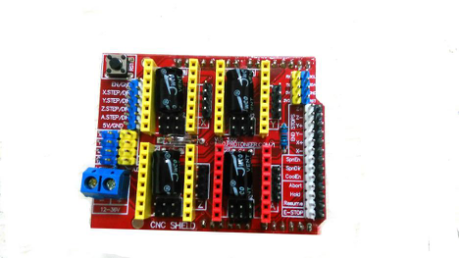

Step 2: Control a Step Motor
step motor:
Arduino Uno-----------Expansion board
8------EN(stepper motor driver enable, active low)
7------Z.DIR (Z axis direction)
6------Y.DIR (Y axis direction)
5------X.DIR (control X axis)
4------Z.STEP (Z axis stepping control)
3------Y.STEP (Y axis stepping control)
2------X.STEP (X axis stepping control)
As the picture above, it showes us the step motor and we should put the tow lines with 5V and GND. Then move them to the tow tops shows on the picture.
And I showed the program below.

I used pin8,pin5 and pin2 for it. Pin8 can control the x axis and the board can control x,y,z three step motors. I want it to work when I press the button. But this is just a test for the project. In the end, I want to use we-chat payment to control it.

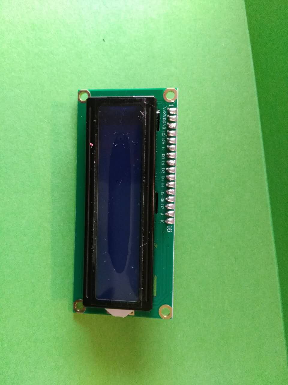

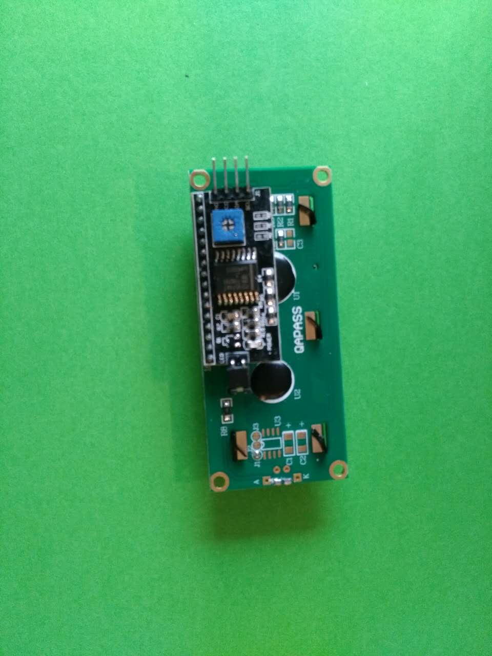

Step 3: 1602LCD
This robot use internet to work. And it has some payment so I should do something to show the consumers that they have bought the things. So I put a Lcd on it to show the consumers that their payment's success.
Then I will show you the program:
#include <Wire.h>
#include <LiquidCrystal_I2C.h>
LiquidCrystal_I2C mylcd(0x3F,16,2);
void setup() { mylcd.init(); mylcd.backlight(); }
void loop() { mylcd.setCursor(0, 0); mylcd.print("payment success!!"); mylcd.setCursor(0, 1); mylcd.print("Thank you!");

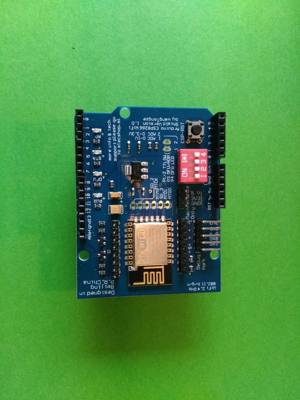

Step 4: Esp8266---Wifi Module---but Use Bluetooth Now
This part is about the most difficult part of this robot. We should connect it into the internet and use some internet payment to finish the work. Then we can use it to get the candy. But this part is too difficult for me now, so I want to use bluetooth to make it. I wish I would finish it and I will release it again. For using bluetooth, I use HC-06 that is a kind of bluetooth equipment.

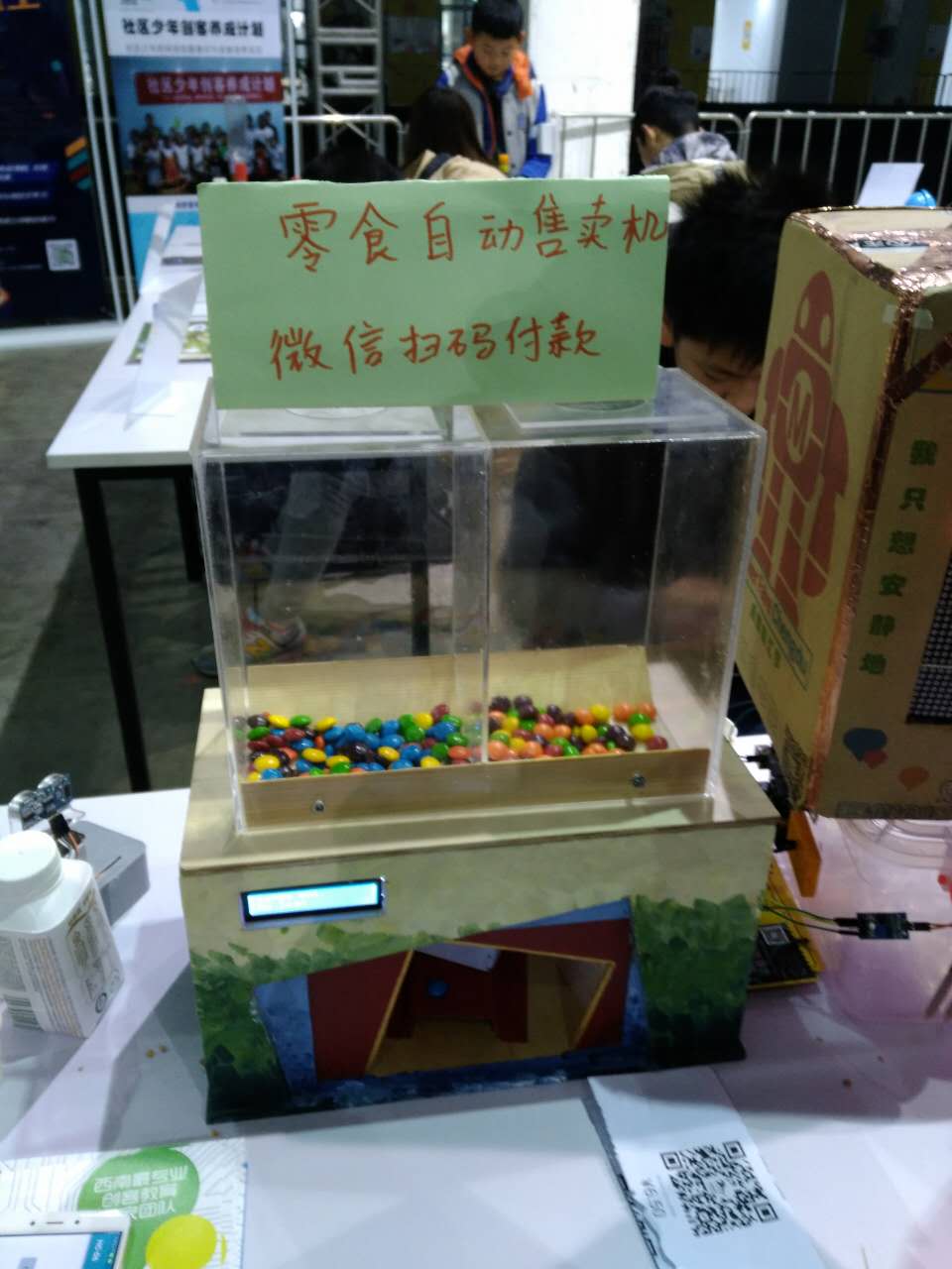

Step 5: The Case of the Robot
You can make it by yourself. And I will show you my case. I wish it can help you.
