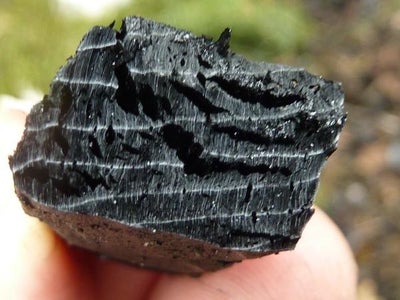

CO2 can be brought into the soil as (wood) charcoal without complicated technical aids. A piece of charcoal acts like a sponge that can absorb water and nutrients and provide a habitat for countless microbes thanks to its enormous surface area. The surface of a single piece of coal can be the size of half a football pitch.
The principle is not new; it was practiced a long time ago by the indigenous peoples of South America in the form of “Terra Preta”.
Where does the coal come from?
Producing charcoal separately means little profit or high costs. We don't want to use our charcoal as barbecue charcoal. Our charcoal must therefore be a by-product.
Do not buy barbecue charcoal! That would be a waste of valuable wood. Only use dry waste materials.

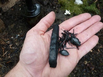

As I proved in experiments back in 2014, not only waste wood, but also hay, coconut shells, bamboo and apricot kernels can be carbonized by pyrolysis. The important thing is that the material is reasonably dry.

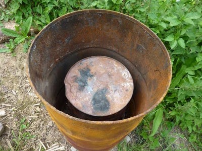

You will need only a few tools to make a pyrolytic oven: hammer, pointed chisel and tin scissors. I assume that the barrels are open and empty. Only the large barrel needs a lid.
We make air holes all round the bottom of the side wall of the large barrel using the pointed chisel. Find the centre of the lid and mark the future opening with the stovepipe. Starting from the centre of the circle, cut to the edge of the circle and bend the metal strips upwards. We can then place our stovepipe on this corona. This is important to create the necessary chimney effect and draught in our stove. It also keeps the smoke away from you.

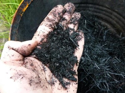

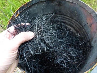

Now we fill the small barrel tightly with the material to be carbonised: wood, hay, straw, nutshells, bamboo, bark, etc.

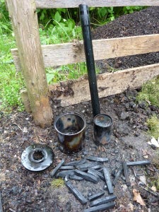

We place this small barrel with the opening facing downwards into the large barrel. The space in between both barrels is now filled tightly with wood. Firewood is also placed on the small barrel, which is then lit. Once the fire is strong enough, the lid with the chimney is placed on top. It now takes about three hours for the wood to burn and for the heat to char our material. No further work needed, just wait.
The outer fire provides the heat for the process. The inner barrel does not get any oxygen, so burning does not take place. However, the heat causes the material to gas out, carbon monoxide escapes and in turn feeds the outer fire.
When no more smoke is emitted, allow the barrel to cool slightly and open it.
