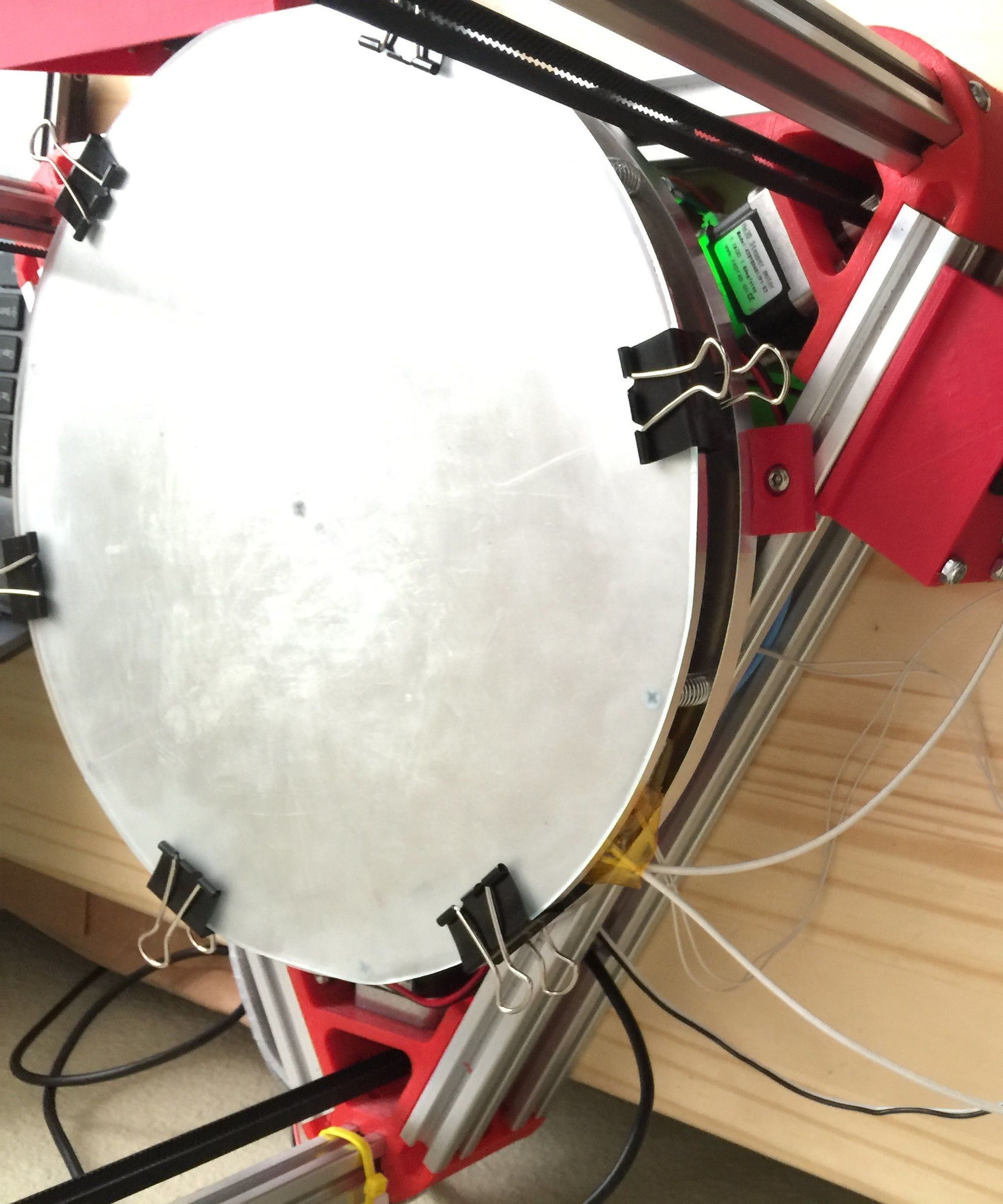

    I have a kit, very similar to yours I got off eBay for about $200. You have to go into it with the mindset that you are building a diy printer and just buying all the parts in one kit. With alot of tweaking and modding you can get quite excellent prints. My stuff now looks better than what I see alot of makerbots putting out. I was lucky enough that mine worked pretty good right out of the box. But I recommend printing a fan duct like the one I attached a picture of for far better bridging. Also aquanet hairspray on the glass and you will never have a PLA print lift. I respray the bed only every 10 or so prints right on top of the old without cleaning and my prints stick perfectly but once the bed comes down to room temperature they pop right off.
