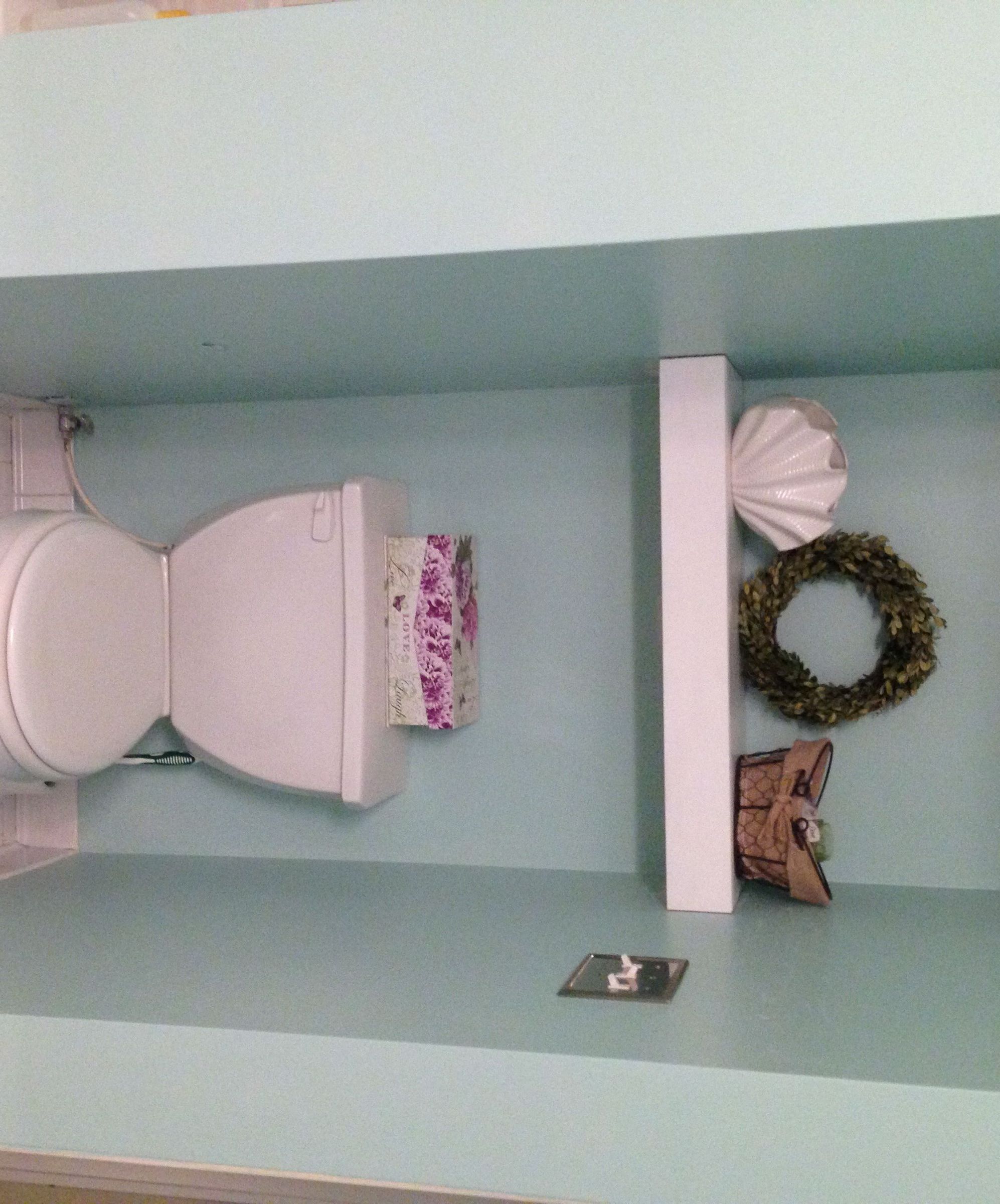

Step 3: Step 3: Building Shelves and Hanging Chair Rail
I wanted some shelves over the toilet to add extra storage and take up some unused space. I also wanted hooks to hang towels on instead of a towel bar, because I think it looks better, and I don't have to worry about constantly straightening the towels!
For the floating shelves above the toilet I measured the width and depth between the walls and cut some 1x4 pine boards to size. I used a stud finder to locate the studs in the walls and then used wood screws to fasten the base to the walls. I used a level to make sure everything was straight. For the base I used cheaper pine than for the front apron ( as you can see some knots and gaps if you look under the shelves-you can't tell from a standing point of view though ; )
For the top of the shelves I used a straighter? piece of 1/2in x 10in x 8ft pine board and cut to size. I attached another straighter? nicer piece of 1x4 pine board to the edge of the shelf top to create an apron and hide the frame, by using finish nails. I counter-sank them and filled in the holes with wood filler, sanded, and painted everything bright white like the trim. I simply sat the top of the shelf onto the frame and voila! floating shelves!
To add a little bit more character to the silver hooks I bought at home depot, I used a straight 1x4 pine board and attached to the studs in the walls. I painted it the bright white like the trim as well. Then I just screwed the hooks on to the board.
