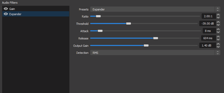

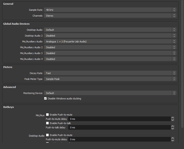

So although all your physical additions will make a massive impact sometimes digital tweaks can have a great effect on sound quality: Using OBS (Open Broadcasting Studio) you can set filters in your mic input:
set the following:
  • use an expander with the release set to roughly 550ms
  • add a gain filter through the filters tab in needed (this gain setting seems to be more clean that the default one)
the next step is to do some trials, this is the best step to complete trial and error with position of the mic and possibly adjust the sound pads. depending on circumstances you can add more sound proofing in the form of blankets or pillows or just more foam.
