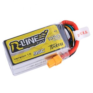

Step 4: Choose Lipo Battery & Others Parts
Another necessary part is choosing the best lipo battery with trungy nano-tech or Tattu, because they are powerful enough to make your flight possible.
