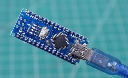

To build a DIY soil moisture meter using an Arduino Nano, you will need the following materials:
1)Arduino Nano
2) TP-4056 Module
3) Capacitive Soil moisture sensor
4) Lithium Battery
5) MT 3608 Boost converter
6) SSD1306 Display
7) Jumper wires

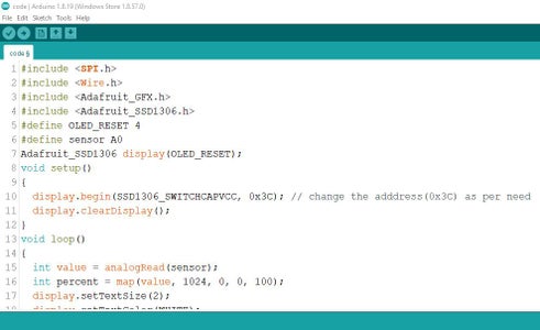

Step 5: Upload Codes
Copy the following code and paste it into the Arduino IDE. and hit the upload button.
Source Code
#include <SPI.h>
#include <Wire.h>
#include <Adafruit_GFX.h>
#include <Adafruit_SSD1306.h>
#define OLED_RESET 4
#define sensor A0
Adafruit_SSD1306 display(OLED_RESET);
void setup()
  display.begin(SSD1306_SWITCHCAPVCC, 0x3C); // change the adddress(0x3C) as per need
  display.clearDisplay();
void loop()
  int value = analogRead(sensor);
  int percent = map(value, 1024, 0, 0, 100);
  display.setTextSize(2);
  display.setTextColor(WHITE);
  display.setCursor(0,0);
  display.println("MOISTURE");
  display.print(percent);
  display.print("%");
  display.display();
