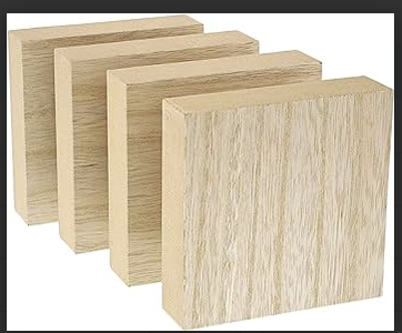

1 piece of wood 10x9 inches 2 inches thick
2 pieces of wood 7x5 inches 2 inches thick

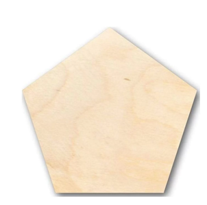

2 pieces of wood in the shape of a pentagon 3 inches tall 4 inches diagonal 2 inches thick
4 pieces of wood 1 inch thick 3 inches long

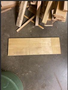

First you want to get a fine piece of wood around 20x8 inches similar to the picture above. Then you want to Cut a piece for the base around 10x9 , then 4 pieces of the sides around 6x5 and 2 of those pieces needs to be a shape of a pentagon and to make that get a protractor and ruler and measure 135 degrees and 45 degrees and cut along that to get that shape. Then 4 pieces of wood that is 3 inches long 1 inch thick to put along the sides of the pentagons. Then a piece that's 5x6 as the roof.

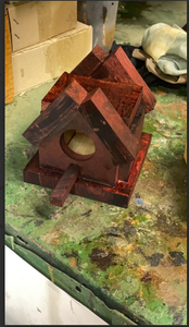

You then want to after all you parts are assembled. You but the base on the bottom ( the biggest piece of wood ) . Then the other 6x5 pieces sides of the base and with 1 of your pentagons you want to drill a circle hat is about 1.75 diameter then with your 2 pentagons glue them to the other bases of the birdhouse. Then you glue to roof on top with your 4 pieces that are 3 inches long 1 inch thick put them along the sides of the pentagon. Then you get a small piece of wood that is.5 inches thick and 3.5 inches long to glue to the sides to act as a stand for the birdhouse. Then you choose your color of stain that you want and paint it. Then your done!
