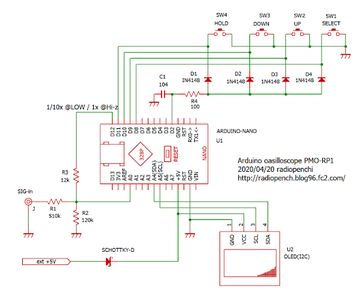

Step 1: Circuit Diagram Overview
The circuit connects the signal input through a voltage divider and optional attenuator into the Arduino Nano's analog input pin A0. The I2C OLED display connects to A4 (SDA) and A5 (SCL). Push buttons use diodes to combine input signals and are connected to digital pin D2 for interrupt-based operation.
For signal safety and accuracy, a Schottky diode prevents overvoltage, and resistors scale the input voltage properly.

Step 3: PCB Layout and 3D Model

The PCB is compact and integrates:
  1. An Arduino Nano socket
  2. SH1106 OLED display
  3. Four push buttons
  4. Voltage divider and attenuator circuits
  5. Power terminal and decoupling components
This layout allows for clean assembly and easy usage in a handheld device or benchtop tool.
