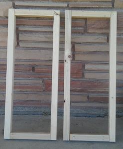

Picture 1 - Take (2) 9" 2x2's and place them inside of (2) 30" 2x2's to make a rectangle. Fasten the ends together using 2-1/2" screws. Do this twice to make 2 of these walls.
