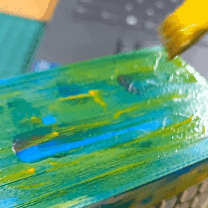

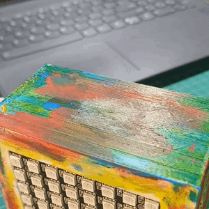

Assemble the antennas for your TV. First, cut two wires approximately 6 cm long and bend 1 cm of one end. Then insert the wires into the antenna stand's holes (Piece 3). Glue them with instant adhesive and paint them the color you want, then stick them on the TV itself (Part 1).
You can also paint your game console any color you want. In my case, I chose to paint it with an abstract style, simulating its wear and tear. On the cover, I wrote the word "Retro" in a curious way, alluding precisely to the theme of our TV.
