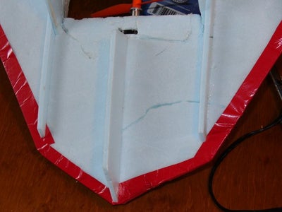

Step 3: Glue the Fins and Reinforcements.
Apply fiberglass tape around the propeller cut out for reinforcement and glue on a strip of 1/16" x 1/4" balsa (some fliers use carbon fiber rods and strips).
Glue the tail fin and nose fin onto the body of the plane using the hot-melt glue gun. Insure the fins are aligned dead center of the body and not angled in any way. At this time, you can also add the other reinforcement strips. These are just strips of foam cut and glued along the bottom of the fins and along the sides of the propeller cut out.
Also visible (through the cut out) is one of the two fins on the far side. These two fins help prevent the propeller on this plane from damaging the opponent's plane. I'd suggest waiting to glue these on until the electronics are installed, it'll make it easier because the plane will sit flat on the table.
It's a good idea to apply a strip of low temperature covering or fiberglass tape to the leading edges of the plane. This is a vulnerable area and the covering or tape will help prevent rips and tears from impacts.

After a wild afternoon of battle Monday with SEVEN warps in the air at once, my poor plane took a beating. The whole nose was crumpled beyond repair and I was about to just remove the electronics and start building another when I thought "Hmm, I wonder if I could just cut off the bad part and make a replacement?". Here's what I did. I simply cut a diagonal line from the front corners of the propeller cut out to the edge of the plane, cut a piece of fresh foam to fit, hot glued it on and added some reinforcing fiberglass tape, a couple of strips of foam for stiffening and then just remounted everything. I'll see how it holds up this Saturday when I attend the first ever full contact combat event at a RC club field in Huntsville, Alabama.
