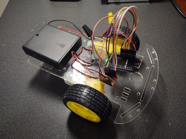

Step 2: Assemble the Robot
First you will need to solder two wires to each of the four motors, I chose to use red and black wires but you can use whatever color you like. Don't worry about which wire goes where. If we get the polarity wrong (the motor runs in the wrong direction) we can just reverse the wires on the L293d motor controller later.
After soldering the wires to each of the motors you will be ready to assemble the robot, to do this follow the instructions provided in the packaging of the kit. Also, you can watch the first part of my YouTube video to see how it's done.
Step 3: Some Assembly Required
After assembling you robot car it should look something like this. Be sure to look at the orientation of the motors and the wiring so that they are facing the right way and the motor wires are facing inward - toward the inside of the robot. Hint: a little hot glue between the motors and the chassis will add rigidity and strength to the assembly.
P.S. This is where the patience comes into play! There are alot of screws in the kit.
