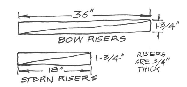

Step 11: Cut Bow and Stern Risers
The drawing below shows how you can get two risers out of each board by cutting it in half at a diagonal.

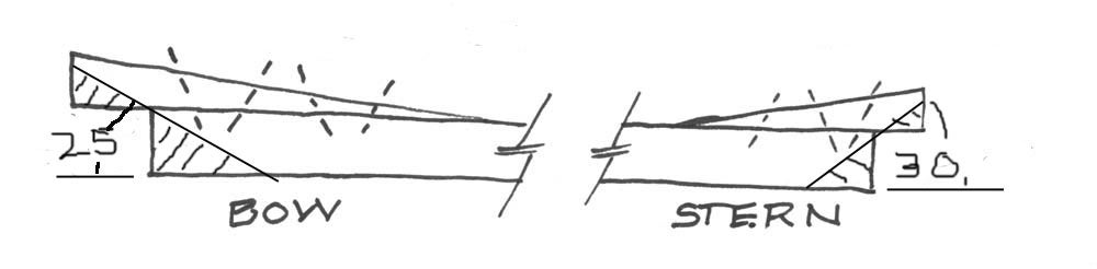

Step 13: Trim Gunwale Ends
Trim the bottom edge of the bow end at a 25 degree angle. Trim the bottom edge of the stern end of the gunwales at a 30 degree angle.
These angles are the angles at which the stem and stern boards will be attached to the gunwales.
The stem slopes at a flatter angle than the stern.

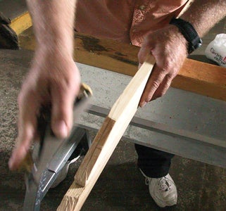

Step 14: Shape Tops of the Risers
Use a hand plane or spoke shave to shape the top edge of the risers to a slightly concave form so they fair in nicely with the tops of the gunwales.

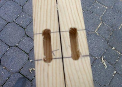

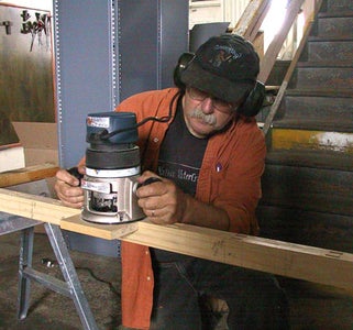

Step 15: Cut the Rib Mortises
Now we're done with the tops of the gunwales and are ready to cut the rib mortises.
Rib mortises are 1 inch long, 1/4 inch wide and 1/2 inch deep and are centered on the bottom edge of the gunwales. If you have a router and 1/4 inch bit, that is the fastest way to cut the mortises. If you don't, drill a 1/4 inch hole on either end of the mortise and remove the wood inbetween with a 1/4 inch chisel. Wear ear protection if you use a router.

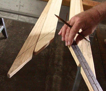

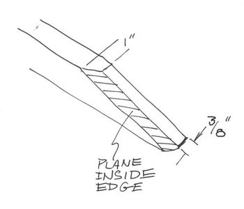

Step 16: Mark the Ends of the Gunwales for Planing
The ends of the gunwales will come together at an angle, so you want to plane them so they have some flat surface where they come together. You will mark the wood that you want to plane off. The diagram below shows how to mark them.

We need to do one more marking step once the nails are removed. See the photo below for how to do the marking.

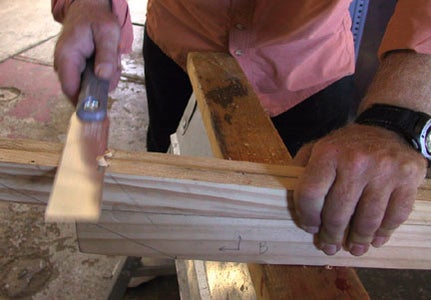

Step 18: Plane the Ends of the Gunwales
Remove the marked wood with a hand plane. See the picture for what this looks like.
