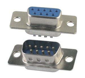

Duel db9 Serial Ports
Since I wanted to be able to connect my router to things such as GPS serial ports were a must.

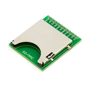

SD/MMC(Secure Digital Multi Media Card) Reader
Due to the routers limited memory capacity (4 MB of flash) an SD/MMC reader was also a necessity.

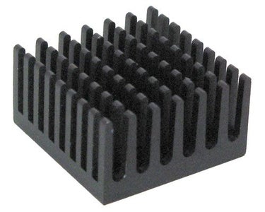

Heatsinks and Fan
Heatsinks and a cooling fan would also be needed to help remove excess heat produced by over clocking the CPU and boosting the outgoing signal strength. A 28x28x15mm heatsink and a 70x70x15mm 43 cfm fan were chosen. A 3 watt 100 ohm potentiometer was required to adjust the speed of the fan. This allows the user to not only control the amount of airflow but also to reduce the noise the fan makes when operating at high rpm.

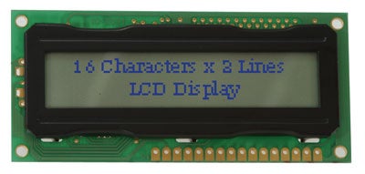

LCD Screen
As an added bonus (and just to see if I could do it) I decided to add a 16x2 LCD screen to view statistics and code as the router is running.

Electronics 15748DB9 Male Connector, Solder Jameco 1 $0.75     $0.75
Electronics 15771DB9 Female Connector, Solder Jameco 1 $0.75     $0.75
Electronics 6140964-40 Hex Jack Screw Set Jameco 2 $1.95     $3.90
Electronics 00204SD/MMC Breakout Board sparkfun 1 $9.95     $9.95

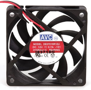

Electronics 212556170 X 70 X 15 Fan Jameco 1 $6.95     $6.95

Electronics HS-2728 X 28 X 15mm Heatsink All Electronic 1 $0.45     $0.45

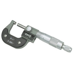

Micrometer
It's a good idea to have a decent micrometer on hand in case you encounter a situation where a caliper will not work. Again, generally higher quality and more accurate tools cost a lot more but due to the type of project we are working on a 1” micrometer from Harbor Freight will work just fine.

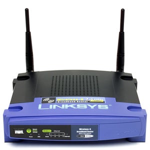

Step 4: Reverse Engineering and Modding
When reverse engineering and modifying any product it helps to know how the existing object was manufactured and how the modded one will be made. For example I know that the factory Linksys case was injection molded from visible ques such as parting lines and injection locations.
Since I know these are injection molded pieces there are a few assumptions I can make.
  1. Most likely wall thickness will be between 0.040" and 0.120" (depending on the size of the part).
  2. That the part will have draft angles of no less than 1º opening in the pulling direction.
I found that the draft angles on my parts were roughly 3º which means the part gets larger as I move from front to back. This is important because if it were reversed (part got smaller from front to back) the part would not be able to be pulled from its mold. You will notice from the images that the part varies almost 0.030" from front to back, although this might not seem like a lot it can and most likely will mean the difference between parts fitting or not.
In order to "double check" my accuracy I decided that I would reverse engineer and model an exact copy of the original Linksys case and I would make "envelope" 3D CAD models of all the components that were to go inside the case. After about four days I had finished all of the models and was able to assemble them in CATIA. Believe it or not all of the models lined up perfectly with the exception of one antenna hole which was off by roughly 0.025". After a little investigation I discovered that I had keyed in a dimension incorrectly and I was able to resolve the issue in a few minutes.
Note: The key to making an accurate 3D model is to take your time and A LOT of measurements! Double, triple even quadruple check your measurements! I know from experience that it is easy to misread a measurement and you will spend hours trying to figure out why everything doesn't line up.
In the images you will see a hideous first attempt at modifying the case to house the LCD screen and fan. I went through about a half dozen versions before we came up with a design I liked and went with. Remember, designing is generally an evolutionary process; one change leads to another, some features stay, some go, some change and some stay the same. My final model has subtle features from almost every version I came up with.
In the end I wound up raising the upper surface 0.750" and flowing it back down to the original upper side edges of the factory case. This allowed me to keep a somewhat factory shape to the case. I then flowed the surface down to the original front edge giving it a nice organic shape. I extended a pad out of the front to house the LCD screen and louvered the upper surface to allow for heat exhaust. The rear of the case remained almost stock with the exception of the upper section where the DB9 connecters are mounted. You will see these in an image of our router nested on top of a factory Linksys router.
