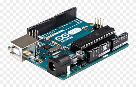

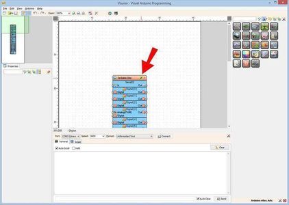

Step 3: Start Visuino, and Select the Arduino UNO Board Type
The Visuino: https://www.visuino.eu also needs to be installed. Download Free version or register for a Free Trial.
Start Visuino as shown in the first picture Click on the "Tools" button on the Arduino component (Picture 1) in Visuino When the dialog appears, select "Arduino UNO" as shown on Picture 2

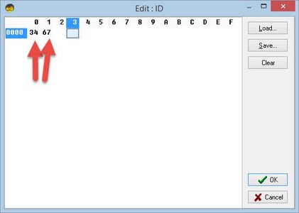

  • Select "AddPacketHeaderID1" and in the properties window select "ID" and click on the 3 Dots button and in the "ID" window set a unique sequence of bytes that will serve as ID, like 34 67 (See Picture)
  • Close the "ID" window

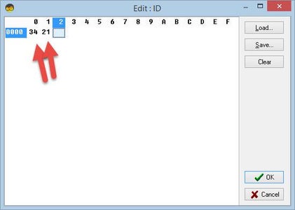

  • Select "AddPacketHeaderID1" and in the properties window select "ID" and click on the 3 Dots button and in the "ID" window set a unique sequence of bytes that will serve as ID, like 34 21 (See Picture)

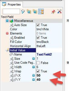

  • select "Text Field2" and in the properties window set "X" to 50 and "Y" to 40

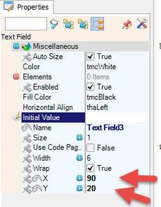

  • select "Text Field3" and in the properties window set "X" to 90 and "Y" to 20

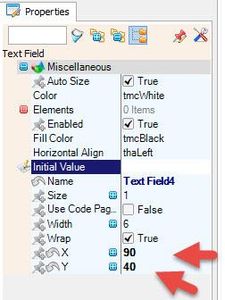

  • select "Text Field4" and in the properties window set "X" to 90 and "Y" to 40
