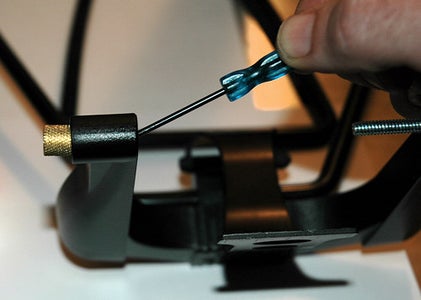

Step 3: Remove the Original Lateral Indicators
The original lateral indicators are simply metal dowels that are held in place by rubber o-rings that allow some resistance and hold the indicators firmly. This system is functional but imprecise and frustrating, since when you are trying to move them a tiny distance to just barely touch the rim you end up either pushing too far or not moving them all!
To remove them, simply grab ahold of the plastic tips with pliers and pull them off, then pull the indicators out the other end. You may find that another set of pliers to grasp the other end is helpful if you have them available, but they should not be necessary.

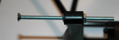

Step 5: Install the First Nut
If you have removed the brass insert, put it back in.
Now you will simply super-glue (or J-B Weld, or whatever) the first nut to the outside of the brass insert - the 10-24 nut I have used actually fits pretty much perfectly within the plastic circle. Be careful to use as little glue as necessary to get a good bond, and do not let it block or gum up the threads in any way! (and if you do get a little messy, remember that fingernail polish remover removes super glue).
Note that the screw hangs a bit after install, which is why we'll add another nut or other support in the next step.
Step 6: Add Another Nut (or Other Support)
Now we'll add another nut on the outside.
Three key points:
1. Put the nut most of the way onto the bolt, then add a bit of glue and back the bolt up to bring the nut/glue to touch the plastic. This way the threading will match for both nuts.
2. Once again, be careful to use as little glue as necessary for a good bond, and avoid getting any on the the threads of the bolt or nut.
3. Back the bolt up only enough to touch glue to plastic. If you "squeeze" it onto the plastic, the threading of the two nuts may be slightly mismatched and make it more difficult to turn the bolt.
Note that an actual nut is not necessary since there is already threading on the first nut. If you can find a washer with the perfect-sized hole to fit the bolt, that would work as well, and maybe even be preferable, because variations in the bolt threading could result in a mismatch of threading between two bolts spaced an inch apart. One option: drill into the second nut with a drill bit just thick enough to eliminate the threading.
That said, I used two threaded nuts on mine and have had no problems.

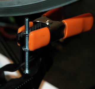

The first step is simply to put two nuts on our third bolt, about an inch apart.

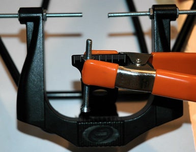

Step 10: Clamp on the Roundess Indicator.
Next we simply clamp the bolt on. Be sure to use the smallest clamp you can find so the weight of it won't pull the indicator down.
I originally thought to simply super-glue this on, too, but I realized that it wouldn't be adjustable for different rim widths. Thus the clamp, which allows you to move the indicator to suit any wheel. And believe me, this little clamp is plenty strong enough to hold the bolt solidly.
Note that you can adjust this setup to any angle. It doesn't have to point straight up and down, as long as the tip of the indicator can touch edge of the rim.
