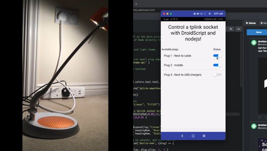

Introduction: Build an Android App to Control Tp-Link Smart Plugs and Sockets With DroidScript
We'll build an Android app using a simple coding tool called "DroidScript" to remotely control a TP-Link smart plug. This tutorial shows you how to remotely control individual plugs on the socket to turn a lamp on and off.

Step 3: Coding
Please follow this video tutorial and feel free to extend the functionality to build something unique and exciting!
I have attached the source code in the next step so you can copy + paste the code into your own project to make things easier for you.
