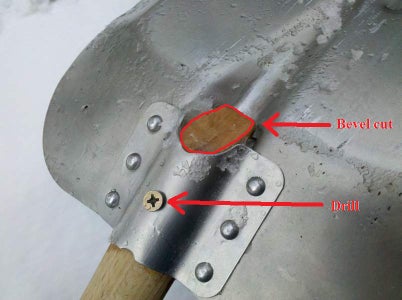

The wood shovel handle has a small curvature, so put the wood shovel handle in the metal hand shovel and try to match the curvature like in the image (curvature is exaggerated). After that, mark the holes and the beveled cutting lines at the end of the wood shovel handle where it is assembled with the aluminuml hand shovel.

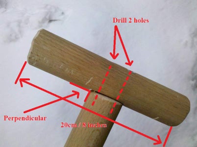

Step 2: Cut and Drill the Wood Broom Handle
Using the panel saw, cut on the marked cutting lines. For this step is good to clamp the wood handle (use a vice) or ask someone to help you.
You should get a small piece of wood handle and the new wood shovel handle after cutting. The wood handle should have a nice beveled end.
The small piece will go perpendicular on the wood handle, to be used as a grip. Drill 2 holes on the small piece (on the diameter) and also drill 2 holes on the wood handle (2,5cm / 1inch depth) in order to assemble the 2 pieces like in the image.
Drill 1 hole also on the beveled end of the wood handle - 1cm / 1/2 inch depth.

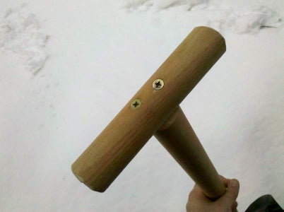

Step 3: Assemble the Car Snow Shovel With Wood Handle and Grip
Now take the small wood piece and the wood shovel handle and using the Philips head screw driver, fasten the 2 long screws in the small wood piece in order to attach it to the wood shovel handle, like in the image. If the hole is too tight for the screw and is hard to fasten the screw, rub the screw's thread on some soap and fasten it, it should go easy now
Are used 2 screws in order to avoid twisting the grip and unfasten it from the wood handle.
After this, the small piece should be assembled perpendicular on the wood shovel handle.

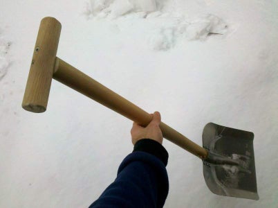

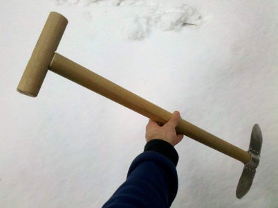

Assemble the wood shovel handle with the aluminum hand shovel, use the short screw as indicated in the image.

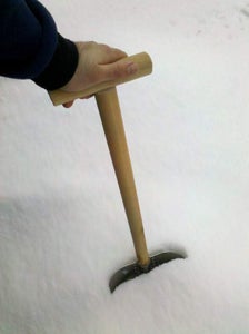

That's all! Now you have a nice car snow shovel - cheap, durable, light and made by yourself!
Some improvements: use 2 small screws to assemble the wood handle to the aluminum hand shovel (need to drill one hole through the aluminum shovel and to the wood handle).
