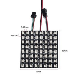

  2. 1x 8x8 NeoPixel matrix (WS2812B) - buy

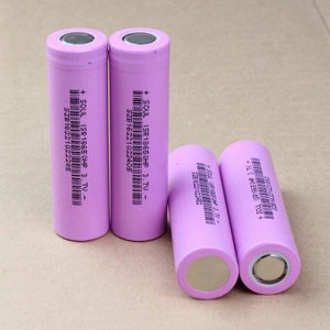

  5. 1x 18650 Li-ion cell

  • 18650 cell to TP4056: Connect the cell's positive and negative terminals to the TP4056's "B+" and "B-" terminals, respectively.

  • ESP32 Power: Connect the 5V output from the boost converter to the ESP32's 5V and GND pins and of the Neopixle matrix Vcc and GND.
  • NeoPixel Data Line: Connect the data line from the NeoPixel matrix to a designated GPIO 13 pin on the ESP32 .

  • then go to led preferences .> change led count to 64 and GPIO to 13 and click save.
  • click back and then go to 2Dconfigrations>check the dimensions i.e. 8 x 8 and select "serpentine" and save
