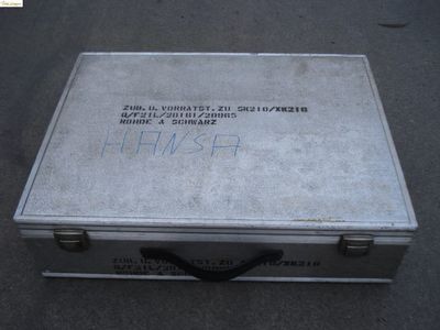

Step 2: Find the Right Suitcase
Finding the right case is 90% of the work. My object of desire should be light but durable so I went for a field-proofed paradmedic suitcase from the german forces. Size depends of your setup but if you plan to build in a 9U of Modules you should consider those values (internal size):
Width: you'll need 48,26 cm inside your frame + the width of the frame itself + some extra space for the power unit
Height: 3U (which is the height of a standard Eurorack module) equals 13,33 cm, allow for an extra and you'll end up with 41cm
Depths: Now, that depends on your modules. Mine are up to 6cm so 11cm of depth seemed enough for me. Also consider a certain depth (2cm) for the cover if you plan to align the front panels of the modules with the top edge of the suitcase, so that there is enough room for the knobs.
Apart from the size you should also think of the materials as well as the construction type. The combination of a thin aluminium shell around a wooden interior sounded good to me and turned out as easy to work with.
