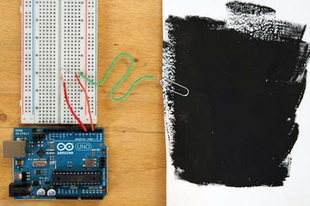

Step 2: Sensor Pad and Circuit

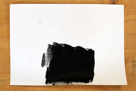

Now that you have your materials together, its time to start building the sensor and the circuit. First you need to paint a pad of Bare Paint onto any non conductive surface. In the video above we've just painted a piece of paper (as seen in the image below). The shape isn't important and the size should be around 100mm x 100mm (4" x 4"). The size of the pad can impact the sensitivity of the sensor, so try a few different sizes if you want and see how this changes the way that the sensor reacts. Leave your sensor pad to dry.

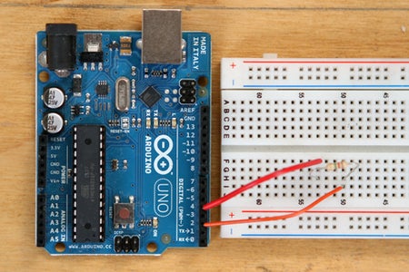

The next step is to build a simple circuit (pictured in image below) containing a resistor between pin 2 (orange wire connecting to the breadboard) and pin 4 (red wire connecting to the breadboard) of the Arduino board. Pin 4 is referred to as the "Sensor Pin" and Pin 2 is referred to as the "Receive Pin". An easy way to create this circuit is via a solder less breadboard.
Step 3: Connecting to Bare Paint

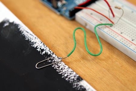

Once you have your circuit built you can connect it to the pad of Paint. Take a look at our connecting tutorial for cool ways to connect to the Paint, but for now, we're just going to use a paperclip soldered to a wire. Whatever the connection type is, the Paint needs to be connected electrically to pin 2 on the Arduino. In the image below, you can see that the green wire is connected to the same row on the breadboard as the orange wire. For further explanation, includinging a wiring diagram, check out the Arduino playground here.

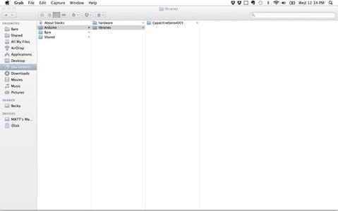

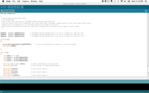

Great! Now all of the physical work is done and we're off to the code. Make sure that you've downloaded and installed the Arduino programming environment. If you haven't, you can find it here. Next, you'll want to download and install the CapSense library. When you unzip the files make sure to put the folder titled "CapSense" into Documents/Arduino/libraries as shown here.

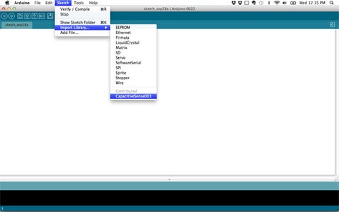

You will know that you've installed the library correctly when upon restarting Arduino you are able to select it from the Sketch / Import Library… menu, as seen here.
Importing
Now that the library is installed, copy and paste the code at the bottom of this tutorial into a new arduino sketch. Load the code onto your Arduino. For more information about loading software onto the Arduino the Arduino site here.
Copy and paste the code below into a new Arduino sketch.

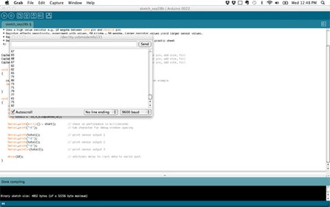

Step 5: Testing

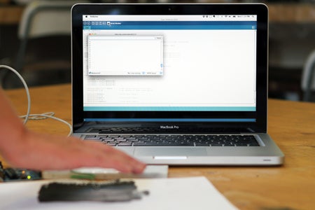

Now we are ready to test your sensor! Make sure that your computer is plugged into the wall, or the Arduino is connected to ground as this improves the stability of the sensor. To check the output of the sensor, open the Serial monitor in the Arduino programming environment (make sure the monitor is set to 9600 baud as that is what is specified in the code). If it is working correctly, you will see a stream of numbers like in the image below. Moving your hand closer and farther from the pad of Paint should change the outputted number. Try swapping out the resistor and test how it changes the sensitivity. Larger resistors tend to make the sensor more sensitive and as such it will work from farther away.
Hey, it works! As Bibi moves her hand up and down the numbers on the serial port monitor change. It's now time to start experimenting. Try swaping the resistor, the pad of Paint or try covering the sensor with another non conductive material. This type of sensor can work on a lot of different surfaces and materials. In later tutorials we'll look at how we can use this sensor to control lights and sound. We want to see what you do with thie tutorial, so email us at community@bareconductive.com.
