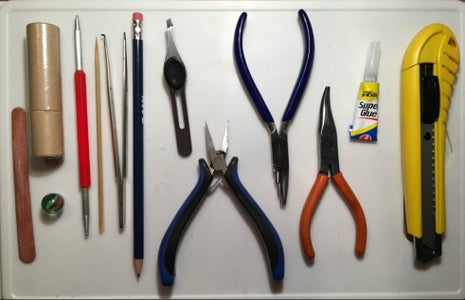

Metal Earth sell a set of tools which go for around $25 or £18, It consists of a pair of flat nosed pliers, some long nosed pliers and a pair of side nippers.
Of course I have lots of tools including all that are in the set. I also raided my wife's super set of jewellery tools to see if they are better.
I have included some notes on tools at appropriate stages during this 'ible.
Step 3: Minimum Tools
I had lots of tweezers, but bought a neat pair from the Pound Store (Dollar Store) they were just right in terms of length and had good strong tips.
Although I have several of the green self repairing cutting boards, I also bought a cheap cutting board specifically for building these models.
I did this for two reasons; first I wanted to keep all this type of kit building in a separate tray that I could use in the living room whilst half watching TV. Second I wanted a nice white background for the photographs.
Although not shown in the tool images I also set up a daylight bulb, magnifying lamp. This can be seen in the title picture and many times throughout this 'ible. Frankly I don't think I could have done all the fiddly part without the lamp and magnifier. Although I am 'old' I think that using a lamp and magnifier should apply to all ages for the sake of accuracy and eyesight health.
The image in this section shows the tools that I ended up using. Apart from those mentioned, I also needed to adapt some long tweezers to reach in and align tabs. I used some neat stepped pliers some angled pliers a knife and a long prong tool.

In addition to basic tools you will find it very useful to have a few 'formers'. Many parts need to be bent or curved around a suitable former. I collected quite a few that turned out to be just the right size and shape to help get the bending right. If you do make these models then it will be a good idea to collect a few formers from available items.

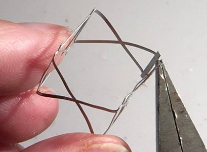

There are two ways of connecting the parts described in the instructions.
One is to bend the tabs over and the other is to twist the tab. Usually the bending is for tabs that will show and twisting is for internal locking together.

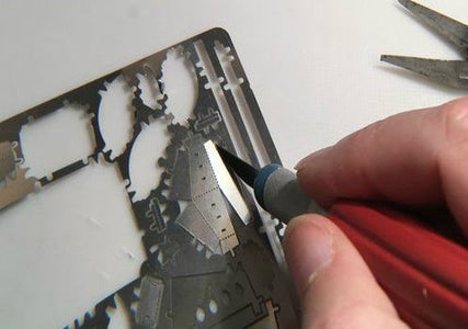

Step 14: My Favourite Way to Remove Parts.
Although nippers are sold for cutting out parts they can leave a burr.
Using a knife needs lots of passes and is not the best way.
I found that wiggling the parts carefully, to and fro, until they detach, is the best method.

Step 16: All the Ways That Do Not Work
Here are all the methods I tried to cut out parts that do not work well.
It really does seem best to use the gentle bending method. This 'work hardens' the part and it just comes away.

Step 19: Bend the Right Way
Some parts need to bend the opposite way to what you may think. Always check.
Some parts are extremely complicated.
I suggest that you try a non permanent assembly for the complex parts.
I had to re-bend a few parts that turned out to be left or right orientated.
