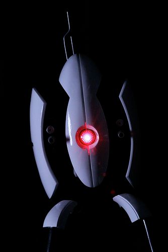

Introduction: Building a Portal Turret With Motion Controlled Audio and Lighting
In this Instructable I'm going to show you how I went about building my very own life size talking Portal Turret from start to finish. This is a fairly in depth project that will cover every stage of construction and all the techniques I used along the way. Hopefully there will be a lot of information that you can pull out of this and use for all kinds of different projects.

Step 9: Electronics
Now here is the fun part of the project! Essentially bringing the turret to life. There are a few main elements that I wanted to incorporate into the final turret. First being the red LEDs for the eye. Simple enough. Second is a series of audio clips controlled by a motion sensor. Third, the ability to play the original Portal theme song.
For those interested I am choosing to leave out the functionality of playing the audio clips when the turret is picked up, as well as the related audio clips when the turret is knocked over. The reason is pretty simple. This guy is not being built to take the abuse of constant handling or being knocked over all the time. While the individual parts of the turret are fairly strong, the assembled turret will be somewhat fragile on those very thin spindly legs. For weight reasons I am also leaving out the ability for the arms to move around like they do in the game. All of the extra engineering required with components and servos would likely add a good bit of weight to the turret. It would be cool, but I'm going to stick with a static model. Same with functioning guns... it all comes back to the weight.
Alright! After hours doing research on Mouser and Sparkfun researching components, and much experimentation, This is the list of parks that I settled on. The main components include an arduino uno, mp3 trigger, power regulation board and an epir motion sensor. There are various other smaller components like switches, buttons, LEDs, resistors, the speaker, battery packs and wall jacks. At the bottom of this page are two links to places you can pick up all the materials I used.
The programming was all done in the Arduino environment. Since I would classify myself as a beginning programmer, there were portions of the code that I needed some serious help with. I was able to get the basic functions working but needed help with some of the more complicated stuff. I called on a work buddy of mine, Pedram Javidpour: professional scripter extraordinaire, to help me get this program up and running. I couldn't have finished it without his help! The finished program is attached at the bottom of this page as well for you to look at, dissect, and/or use if you decided to build a turret..
After the program was finished I was ready to start installing all of the electronics into the turret. I decided to split up the components between the arm and the main body cavity. The arm would get the battery pack, wall jack, power selector, motion sensor, main power switch, and the button to play the theme song. There are images of it all installed below.
So electronics in the arm cover power and small components. The main guts of this guy are located within the body cavity. In the picture below you can see the arduino on the right side, the mp3 trigger on the bottom, and the speaker on the left. The cluster of wire at the top link up to the eye. These components were all just glued in place with standoffs.
Installing all of this stuff was definitely tricky. The most important part is just to make sure that you connect up the right wires to the right places and test each component as you go. It will not be fun it you get everything cleanly installed and it doesn't turn on. You will then spend many hours trying to troubleshot where the problem is.

Step 10: Making the Eye
Looking into the soul of an armed and emotionless turret can be slightly hazardous to your health but I really wanted to go all out just in case someone was so inclined as to gaze into the eye of fate.
Taking the time to make sure it came out as good as possible was very important. After finding a suitable plastic lens I could start on making all of the other necessary pieces. Here is an image of everything that makes up a finished eye. The black disks were designed and laser cut to create the groove pattern you see in the final eye. The translucent disk will help diffuse the red LEDs, and the black rod will create the dot in the center.
After roughly fitting all the pieces together I noticed that the light spill coming down the sides of the lens was really messing with the overall look of the eye. I resolved this issue by coating the inside of the lens with black electrical tape to prevent any light leak from happening. This way the only light you will see is coming through the translucent surface of the eye. The final result is perfect.
All that's left is to install the eye and connect up the power. With the electronics finished and installed, all that remains is the detail work.
Materials used for this stage
Skil Router bit cover from Lowes
2" protoboard
4 bright red LEDs
Custom Laser cut and engraved eye detail pieces from ponoko
translucent plastic sheet
Small piece of black plastic rob
Laser Cutting done by Ponoko.com
2" protoboard
4 bright red LEDs

Step 13: Finished Turret in Action
And that's it. All that's left is to take some fancy pictures to show off the result of all this hard work.
Here is a short video of the final turret in action.
