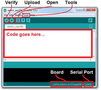

From the Arduino Window, select Sketch > Verify/Compile menu and make sure that you get "Done compiling" message
Use USB connector to conect from your PC to Arduino. Remember to choose the correct Serial Port as images
Upload your Source Code to Arduino and make sure that you get "Done uploading" message
