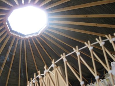

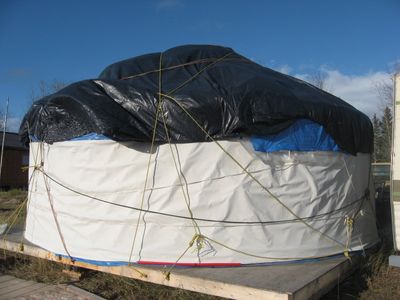

In the spring of 2008 we built a 20x24' wooden platform for a whole new 20 foot gertee. The walls are 7 feet high, the center height is 12 feet, and there's a 4 foot wide roofring with a recycled plastic wndow covering the hole.

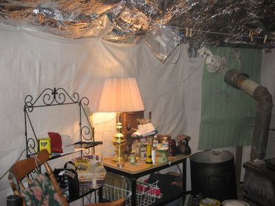

Some of the materials for this one were new, i.e. the white marine duck canvas outside wall cover and the 30' pool cover tarp used on the outside roof. Inside the roof is a layer of used parachute. In October I added an inside layer of painter's plastic and covered it with recycled and new RadiantGuard.

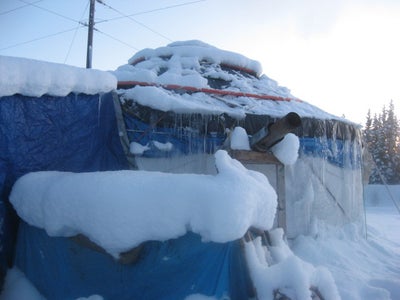

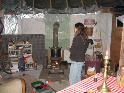

This gertee was Camp Redington's Alaskan Peoples Museum all summer. We began modifying it into a winter home in late September. The remodel is ongoing.
