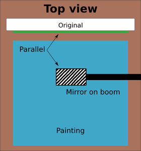

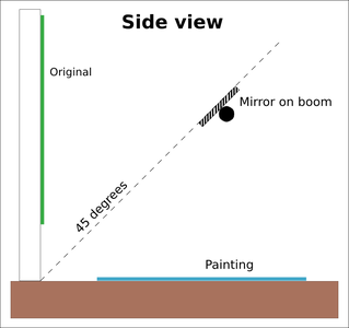

I thought about the problems and realized there were some easy ways to get the angles right. The mirror needs to bisect the angle between the two planes so that the distance to the original and the painting from the mirror's edge is always the same. Doing that is a lot easier if they are 90 degrees apart, so I mounted the photograph vertically this time. Then it was easy to set the mirror to 45 degrees using a combo square.
Next I aligned the mirror along the dividing line between the two planes. You can test this fairly easily if you print out a second copy of the photograph you're painting. (See the attached video for a quick demonstration.) Mount the mirror-imaged one upside down as you normally would, then place the normal version upside-up where the painting will be. Look down past the mirror, and adjust the lower copy so the two line up properly at one point. Now move your head forward. If the mirror is in the correct location, the two images will stay lined up. If the image in the reflection moves farther/gets bigger, then the mirror is too close to the original, and vice versa. Adjust the position of the mirror until they stay lined up.
Keeping the copy lined up with the reflection, test that the mirror is parallel to the painting in the other axis by moving your head side to side. If the images don't stay aligned, adjust the mirror to make sure it is parallel.
