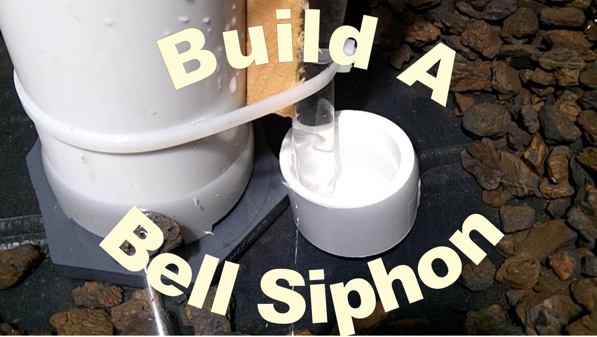

The media beds have bell siphons in them. I’m using a bulkhead fitting through the bottom of the bed for the drain. So that the liner doesn’t get tangled up in the hole saw, I sandwich the liner under a piece of scrap board. These boards a still somewhat damp and the saw is old and worn out so I have to keep cleaning the sawdust from the bit, but eventually I make my way through.
After cleaning the debis out of the area, the bulkhead fitting fits perfectly through the hole. It has a rubber washer that seals against the EDPM liner and fitting. Under the bed, it has a large nut that tightens the fitting in to place.
The stand pipe and drain lines are made from 3/4 inch thin-wall pipe. These bulkhead fittings have a 1-1/8” threaded fitting since it’s what I had in my assorted collection so they need a threaded to slip-fit coupling to reduce it to the right size. I use a temporary stand pipe and fill the grow bed to test it for leaks. I like to fill the beds right up to the rim to test for a worse-case scenario. Plus it’s a great way to check to see if the bed is level and add any shims to the legs for minor adjustments.
Once everything looks good I put in the bell siphon and media guard, and the bed is ready for the expanded shale. Since I recorded this video, I’ve changed the bell siphon design a bit, so click on the link to see these details.
This type of bell siphon uses a trap which helps it to start. The trap assembly is screwed into the bottom of the bulkhead fitting and a section of pipe is attached to the trap and extends to drain into the raft bed.
