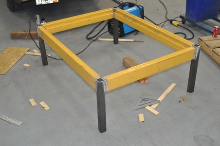

Step 3: Welding the Frame
Next, I welded the frame together.
I laid one of the longer sides on the floor, and put one leg on either end of it. I then checked it for square, and tack-welded it in place. All welds on this project were just tack-welds until I got the frame into it's finished basic shape. That way, when I screwed up, it was easy to quickly grind a small weld or two to undo it.
After welding the first leg on, I repeated with the second.
Next, I made another side rail, with one leg welded on either end.
The two shorter sides won't be able to go on without the "inside lip" hitting on the other piece. So, on the two short side pieces, I used the angle-grinder to cut a 1" notch on the lip. With that removed, the inside supporting lip wraps all the way around the table.
With the glass supported on a large tool box, I was able to put the two side rails around it an rough up the table shape. I clamped the two shorter side pieces in place and tack-welded them.
With the glass out of the way, I checked to make sure everything was square, and then I made all the full welds on the frame.
That still left the legs as hollow tubes that were open on top.
I cut four pieces of scrap plate into 2"x2" squares. These were each set on top of the four corner posts and welded in place.
After that, I used the grinder and flapper wheel to round and smooth the corners of the leg post tops.

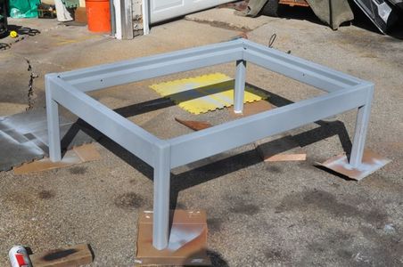

Step 4: Priming and Painting
I used what paint I had on hand.
To start with, I primed all the welds and any other cut ends and bare exposed metal.
After that, I went over the whole frame with a light gray color primer. The light gray covers the project well, but isn't too dark, so I could go over it with a light-colored top-coat.
For the actual paint on this project, I used an Almond color appliance epoxy paint. It's a more durable spray paint, and the color reminds me of 1980's office equipment - perfect for a bank. I also thought that the warm beige would go nicely with the green tint of the glass.
I did one coat of primer over just welds and cut metal, one coat of primer over the whole project, and then one solid coat of paint over the whole project.

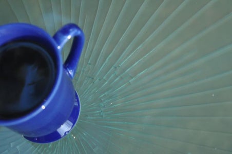

Step 7: Test & Distress
Since this is honest-to-goodness REAL bullet-proof glass, I thought it would be fun to test just how durable it is.
However, I do not own a firearm, and it would be a lot of work to drag the table off to a sportsman's club or a firing range.
I DO have a very big hammer.
I tested the glass by smacking it with a sledge. The only mark is big enough to notice, but only if pointed out to you.
Plus, swinging a sledge hammer is tiring, so I thought I would instead make use of gravity and weight. My anvil is bolted down to a stand, so it would have been a bit of work to remove, but I did have a BOWLING BALL handy.
I set up the ladder next to the bullet-proof coffee table, walked up it with the bowling ball, and dropped the ball directly onto the middle of the table.
